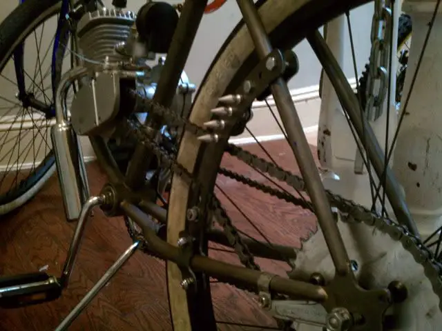

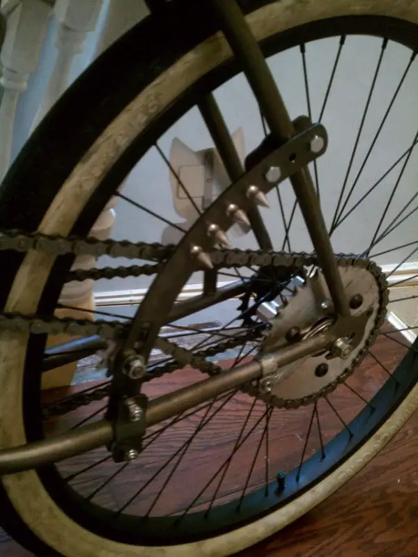

I decided to go without a chain tensioner, but the stock chain was streching faster then i could adjust it. One day I was riding I heard this loud noise coming the motor, I stopped and inspected what was going on. It was the drive side chain, it had streched again and it must have skipped a sprocket tooth. Good thing the wheel didnt lock on me. When I got home try to adjust the chain I saw that it was kinked. So I decided to order a#41 chain and found a nice tensioner on ebay. I also got myself a 10t idler sprocket. I Installed everything on the bike and its running smooth. Chain seems stronger and the sprocket is so quiet that I forgot it was there. Heres my set up
added some tree spikes for decor.
Spanning the chain and seat stay is the best way to mount a tensioner bracket. Yours should give you miles of trouble free riding.
Can't say I'm impressed with the spikes. In a fall I wouldn't want those in my leg.
Right on .. i love the spikes . The curve follows the wheel nicely .
I changed mine up to run without a tensioner also . So far its working pretty sweet , BUT , like you , i can see trouble happening with the chain too . My kit chain is junk .
Out of the box , it wasn,t strait . There is a section of about 15 - 20 links that are out of line with the rest of the chain about .020 ... gonna get a new chain as soon as i have some spare cash .
I was still thinking of adding a tensioner at some point , but right now its not needed .
Do you think that the idler sprocket is reducing the noise from the engine sprocket at all ?
@2door that's what I am aiming for trouble free riding:) but I really couldn't pass up on the spikes.
@diceman2004 Thanks I got the spikes to put on a chopped back fender,but I haven't found a cheap one to chop up
I don't know about reducing the noise from the engine sprocket. Ill keep an eye out on that next time I ride. I did notice one thing the #41 chain is way more quiet then the stock 415.

If the chain is rubbing the tire, switch to a smaller width of tire. My Cranbrook came with 26 x 2.125 tires, the chain rubbed, and I went down to 26 x 1.95 tires, no more chain rubbing.
