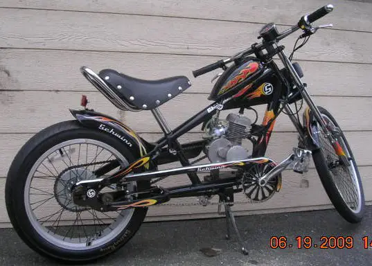

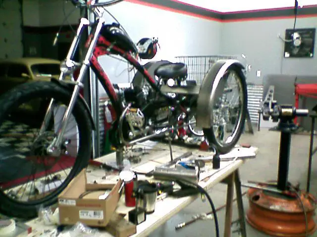

The c-clutch has a one way roller setup(freewheel) built in which allows it to be pedal started. The pull start is not needed. The hand clutch works as normal(always). The idle must be set fairly low. To keep the clutch from kicking in.

You usually need to use the hand clutch when stopping. The motor rpm remains a little to high due to the motor being draged by the chain. Once stopped the clutch can be released. Then you rev up the motor and off you go!
