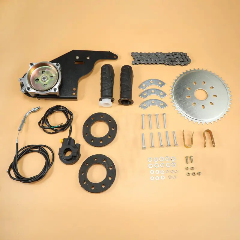

Oops, okay. Has single large spring in center

That looks like a engine that would be used on a 'Go-Ped'.... Google go-peds & go down the line of sellers & see what they have!!

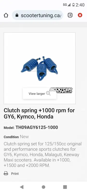

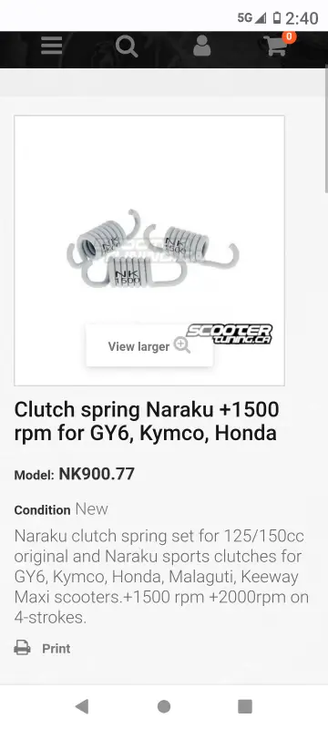

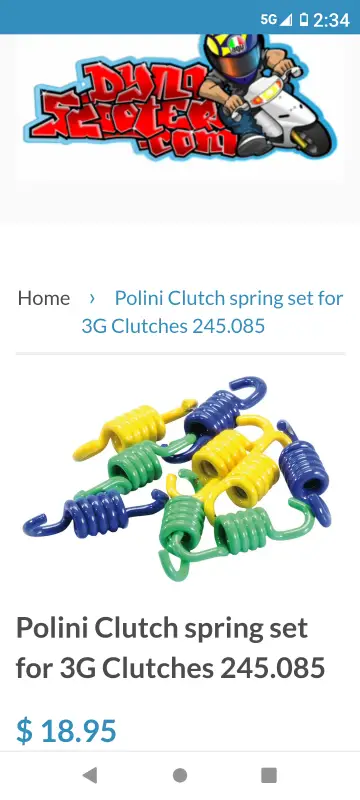

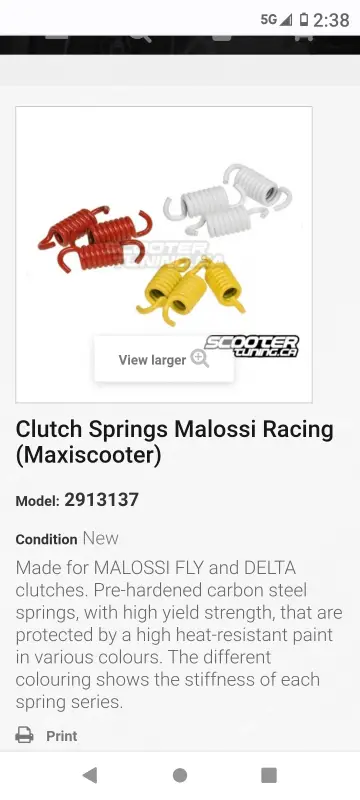

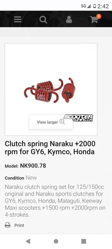

There's many different springs for other things... I would measure the length / size of the coils / thickness of the wire and get a few to try and a direct replacement to mess with... Eventually through trial and error the magic one will emerge... A place that repairs scooters might have done this or scooter forum could have past threads about it... When stretching it I would rig it up so I could measure or have reference... Like hanging a bucket from it and adding weight... So you know about how much got you there... You can never unstrech it if you go to far... A smaller wire diameter everything else being the same is going to be the best reliable way around it...
