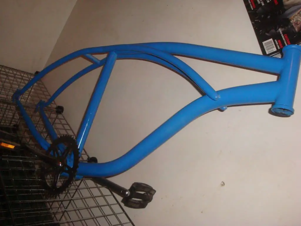

for the past few days i had been tossing around the idea of a trike build.
Something a little more utlitarian! Something to go and fetch bee.... groceries.
Im starting with this, torn back down. stripped. Did it yesterday, and scrapped mostly everything but the frame
so the frame came to work with me and had to have minor surgery preformed from the previous owner mercilessley pounding a seatpost into the tube. Now, a 7" slit down the back of the seattube is all that remains! a little custom chopping at the top and you would never know how many cusses were strewn about the workplace last night during my break lol
this is what we are going to be starting off with

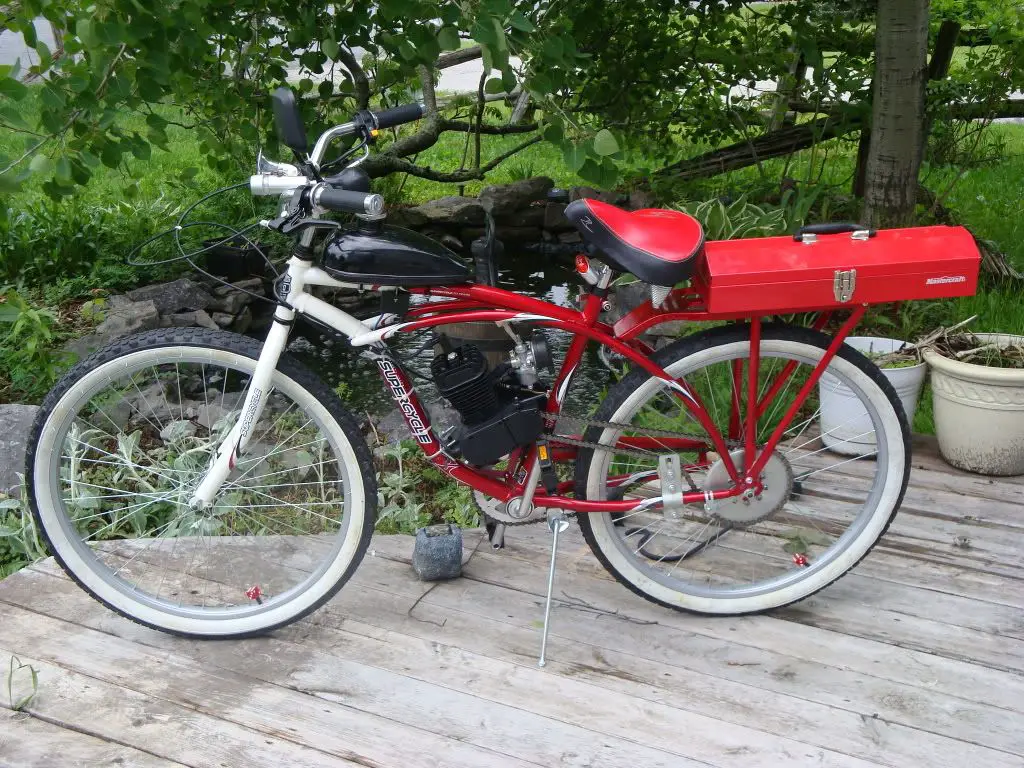

power will be provided by a 66cc PK80 that has been well broken in on last seasons steed equipped with a SBP pipe kit, Maniac Mechanic CNC intake, CNS carburator provided by MotorbikeMike, ADA Racing air filter, A pullstart add on from zoom (which is whom the motor also came from)
