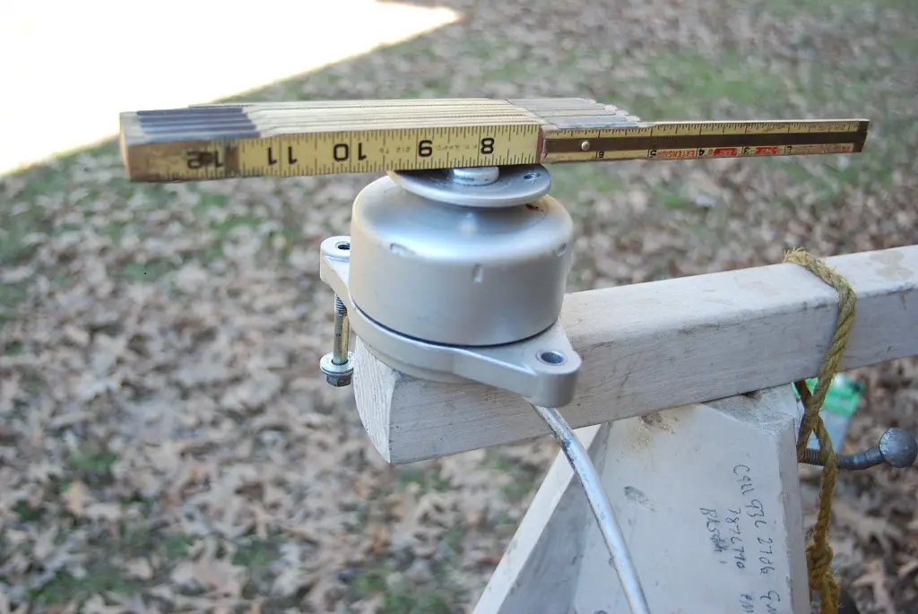

I am using the Kubota dynamo on a push-trailer that is currently under construction. The dynamo produces a lot of drag even at the low drive ratio that I am using. The result is the engine will not start with tension on the main belt. Since the picture was taken, I have added a belt tensioner that I can dissengage when starting the engine. The simple solution would be to run the dynamo after the clutch and not produce power at idle.
