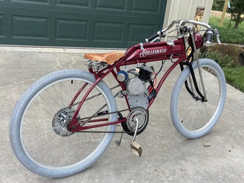

Oldbiscuit Well-Known Member Sep 21, 2021 #6 I built my own intake that was around 4” long with about a 45 deg bend for my last 2 stroke build and it works great. No bogging or loss of power at all.
