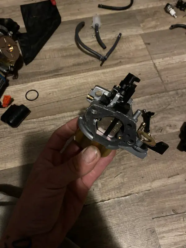

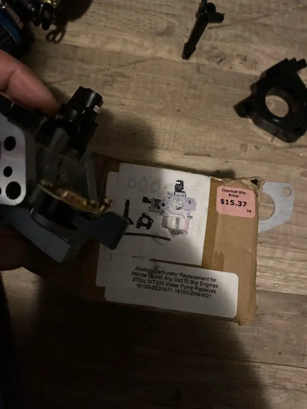

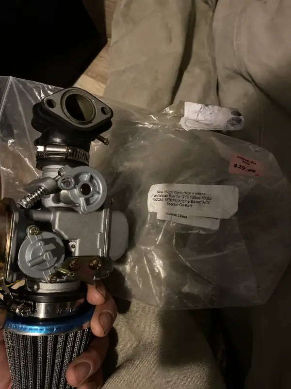

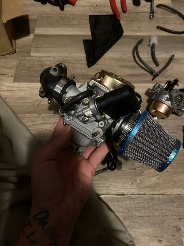

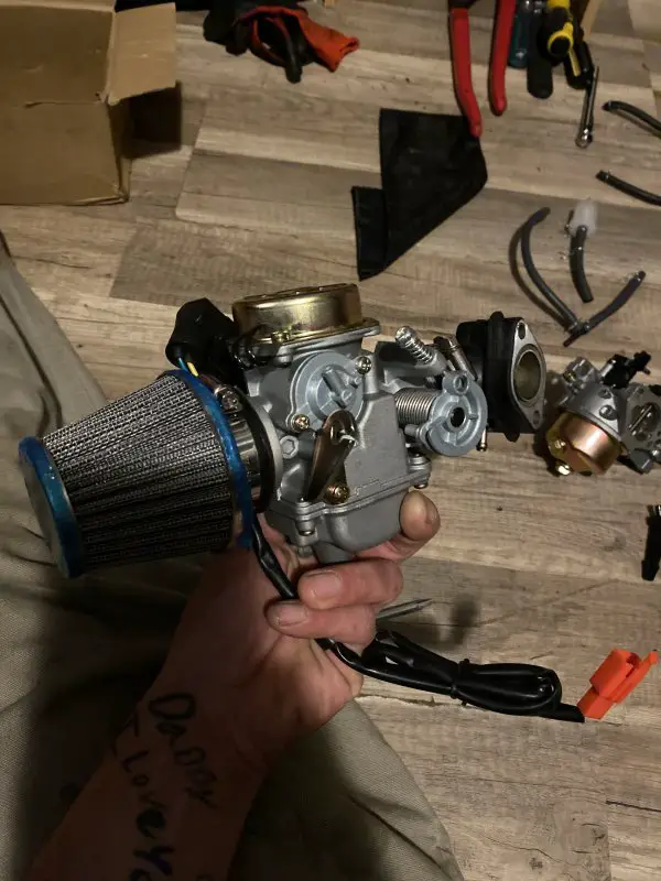

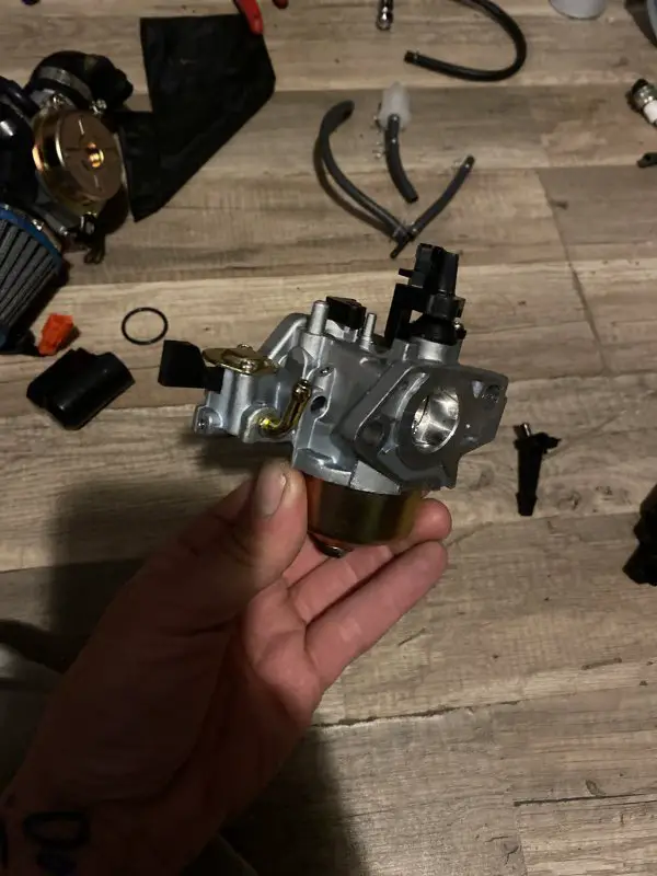

I have a Phatmoto 79cc 4 stroke can I put a bigger carburetor on that engine say a carburetor that’s for a 125cc? Or even a 270cc?? Reason I ask is I got two new carburetors at Mardens for pennies on the dollar and I’m curious if I can upgrade my carburetor to one of those if it’ll give me one a higher speed or more miles per hour or more power or if it would hurt the engine
These first pictures are the new ones and the one I screen shorted are the carb that comes on my engine stocks.

The function of a carburetor is to provide the correct air/fuel mixture at all throttle positions. Engine power is derived from the parts and fits within the engine itself. A carburetor for a much larger engine will at best need only rejetting, but more likely will not work properly due to reduced intake velocity.
If it ain’t broke, don’t fix it. You could get a little more torque by fabricating a longer intake, better exhaust, shaving the head, advancing timing, pretty much doing all “free” mods. A bigger carb usually isn’t one of them unless the specific engine build calls for it (headwork, high rpm billet internals, etc).

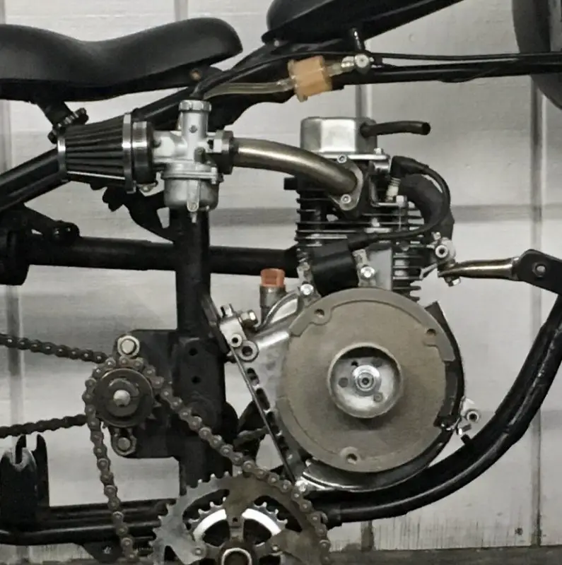

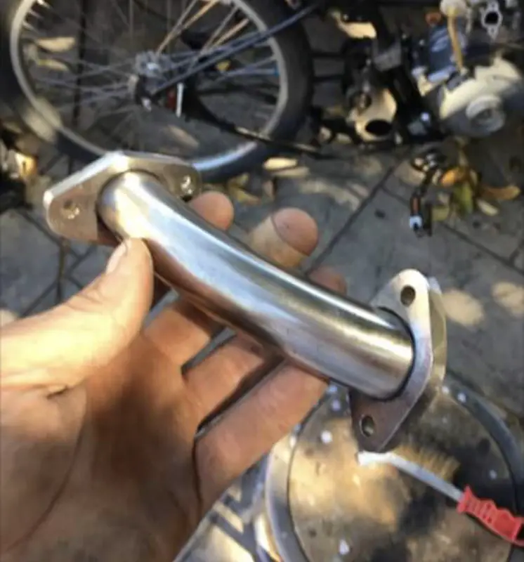

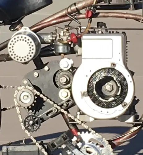

By a long intake I mean increasing the distance between the carb and the engine. Your carb is probably right on the engine. Fab up an intake or find one like my old Briggs build with the s-shaped intake. I think about 3-4” is the best.
Hey Tony01, I've got tons of old Briggs flatheads. I collect them. I've been wanting to build a bike with one for a while. How did you mount yours??
