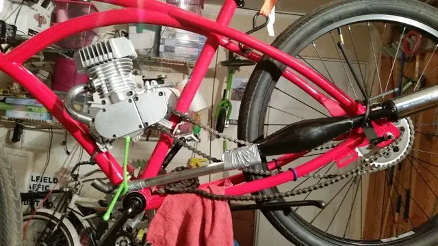

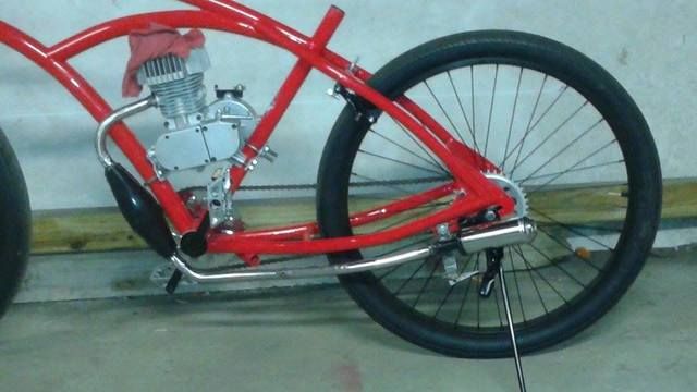

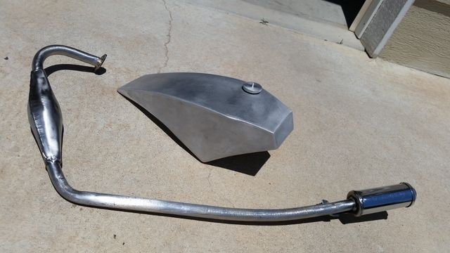

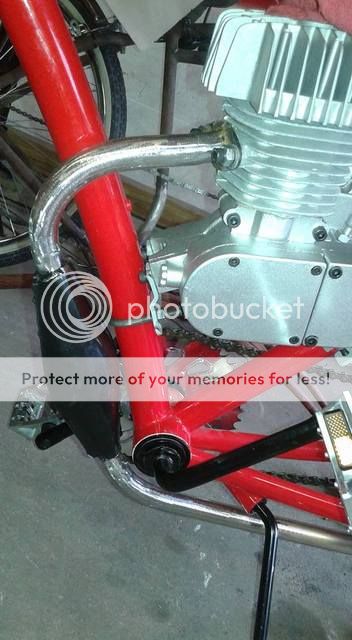

I am modifying my Torquer II exhaust. Does it matter where the expansion chamber is located when I extend the pipe?
Yes of course it matters.
The Torquer II already is tuned for bottom end with a fairly long header.
Google how expansion chambers work.
Extending the header before the first cone like you did will make it ineffective.
How long in inches is the first cone from the cylinder on your install?
I saw your pic on Facebook.
That should work better, but do t weld it together until you test ride it to be sure the power is where you want it... you can do this by using a section of rubber hose and clamping it together, it'll last long enough for testing, then if happy with it you can weld it up, if the pipe comes on too soon and runs out of breath too early then you can shorten the header until it's where you want, and if it's coming on too late, you can extend the header accordingly.
Davezilla;613859if the pipe comes on too soon and runs out of breath too early then you can shorten the header until it's where you want said:
This is my first build so I wouldn't know what running out of breath or coming on too late is like. Not sure what to listen or feel for.
