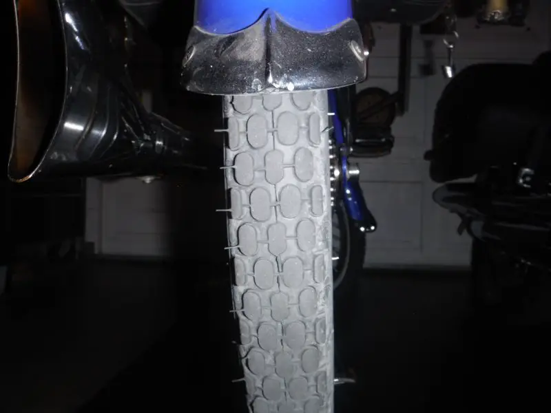

While bicycle tires have come a long way and many tread styles are available
26 x 2.125 Cheng Shin Classic Knobbies (beach cruiser tire)
I used them in the 70s and 80s and i still use them in 2022
IMO 50 mph is about Max for that Bicycle tire
I wouldn't feel safe @ 60 mph for extended periods of time
The rubber might fly off the tire LOL

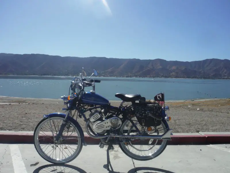

I like the Cheng Shin Classic Knobbie it's got that old skool Retro look that's period correct for my Whizzer. Besides the classic knobbie is for pavement, sand and gravel

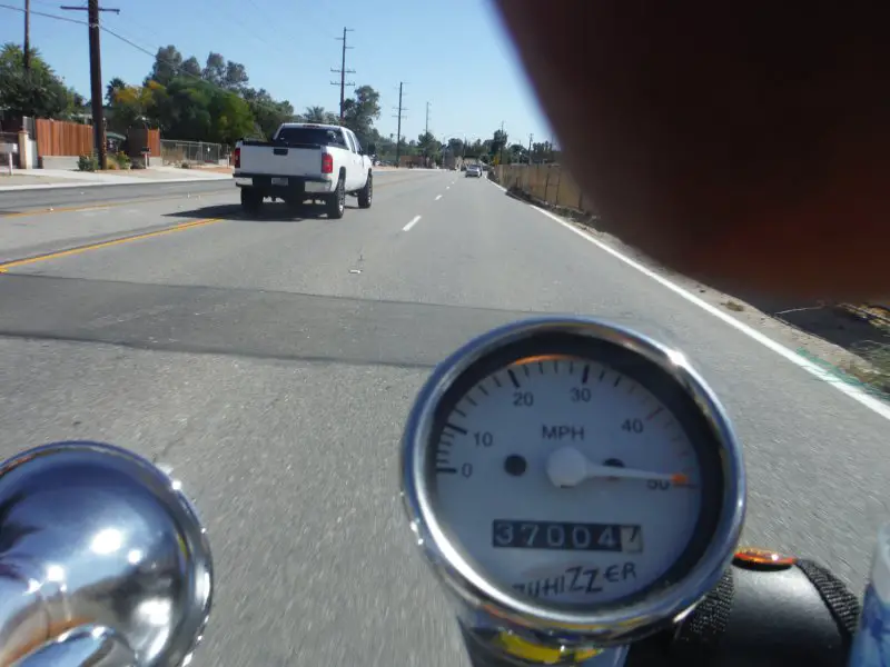

Look at the miles on the odometer, I've never had a tire failure due to speed
The pic was taken a couple years ago I now have over 40K miles
The tires don't last 40K miles LOL. The rear tire lasts about 1,500 miles
My 2005 NE5 Whizzer Top speed is 50 - 55 mph but I cruise @ 40 - 45
Simple tire design, the oldie is a goody
Sure the PSI on the side wall says 35 psi That's because your suppose to put that much psi for sand and gravel But actually they can handle 65 psi just like their close cousin the Cheng Shin CST street tire
I put 45 psi because that's what I like

How would you feel about a consistent 55 on them? Since this is an old bike I'm obviously going to be doing little-no interstates, mostly just US highways and whatnot. So 60 would be pushing it a bit, probably just for passing.
wrench
Aug 20, 2019
770
1,069
93
So Cal
If I could go 55 mph consistently I would be upgrading my wheels
I'm in the 40 - 50 mph range and 55 for only short periods and I feel safe
Mostly cruising @ 40-45
