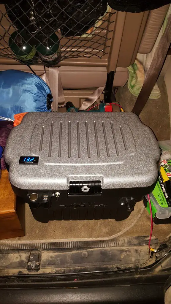

I finally got the bank installed in the van with the voltage meter I ordered online, here's what its current state is.
Dang Cylon. That looks like it was manufactured. Big time, functional art.
I have a real love for a kind of urban, hardware look. So when I make stuff, it always looks like a shade-tree mechanic made it. But wish I had that sorta touch. Really does look like a concept team met with a production team that sent it down to the floor so the engineers could draw it up and then a team of techs made it happen.
Pretty work. Literally.
Question. How does it vent or breath?
