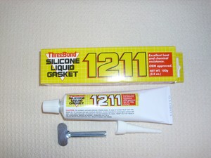

I don't have a great problem getting the NT carb to seal, even without the "O"ring or sealer.
Use the "O"ring and push the carb on tight or use a TINY amount of RTV or 3Bond or YAMABOND sealer.
RTV silicon is not really gas resistant, but it will work.
This stuff is the BOMB! <now investigated by Homeland Security>
If you have to seal cases of flat metal to metal surfaces. Yamabond is same stuff.
Gas resistant and holds quite firm. Used to seal all motorcycle cases that do not use gaskets.
The number doesn't seem to matter much, more about package size, but look it up.
A little goes a long way.

I have seen a couple of NT carbs that the slots were cut too deep and allowed an air (vacuum) leak unless those slots were filled. I've had good luck with a product called 'Seal-All'. It is one of the few that is gasoline resistant. Most silicone sealers are not. Read the label. Most will say "Not compatible with gasoline".
I've never tried Steve's Yamabond but it is probably close to the same product.
The 'O' ring idea is okay but the carb must be pressed tight against it and held there while tightening the clamp or it will not seal.
It's also a good idea to roughen up the surface of the intake manifold a little with sandpaper so whatever you use to seal can get a grip. The chrome plated steel manifolds don't seal as well as the older aluminum manifolds.
