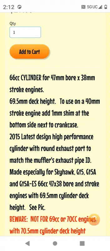

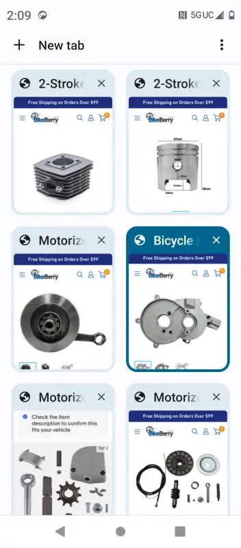

Everything is available from bike Berry with out buying the kit... And grubee has the cylinder... 6mm case 38mm crank... For small down tube frames...
I have a 2012 original grubee Skyhawk nos and want to put them on low rider frame
My first bike had the Skyhawk on it and did 39mph out of the box... Needed a balanced crank was the only thing and a Sha 15/15 carb.. exhaust flange to fit a kx85 pipe
The original 32mm jugs I think I like better but only painted one's are available...
