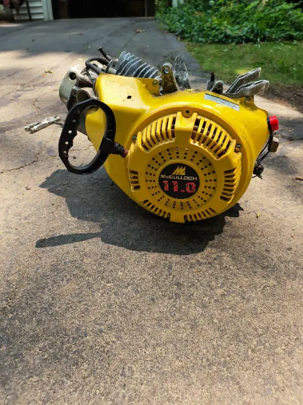

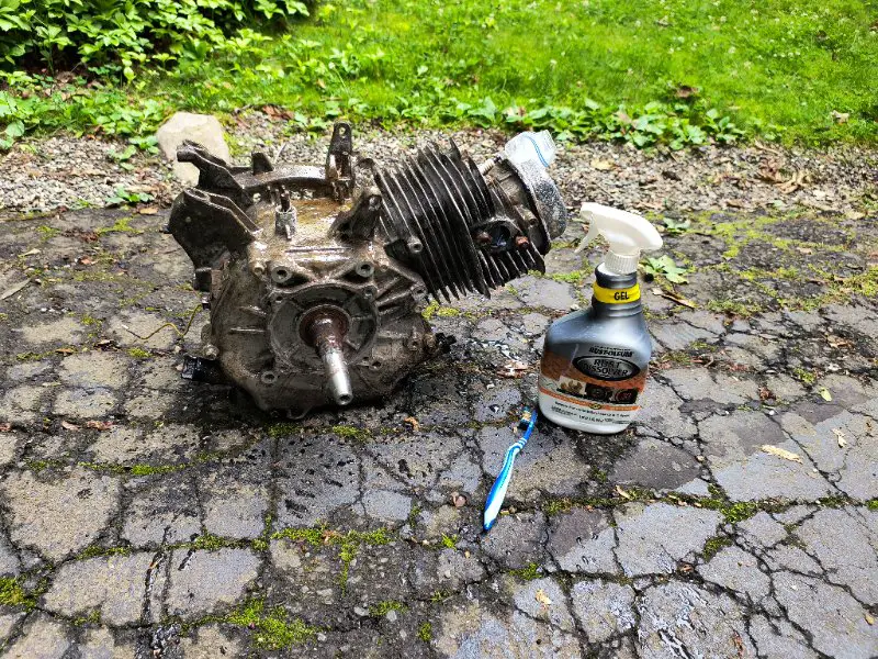

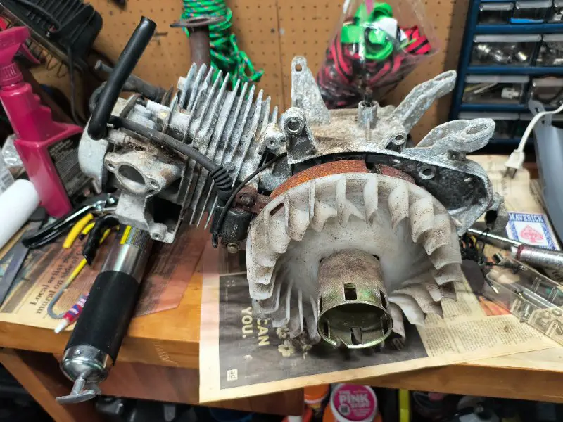

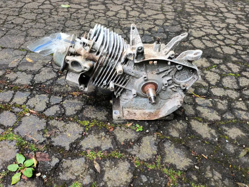

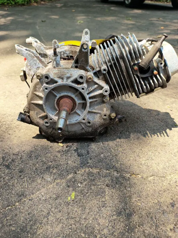

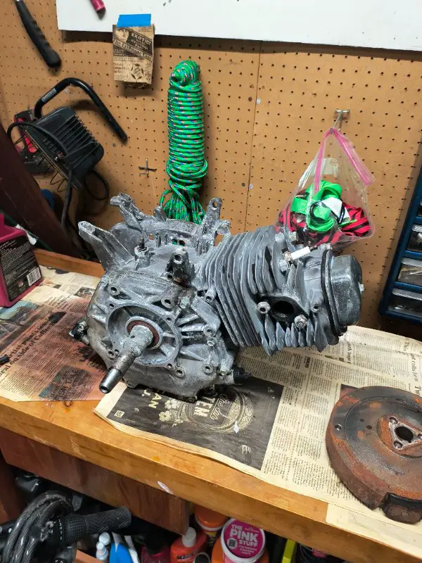

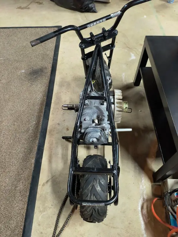

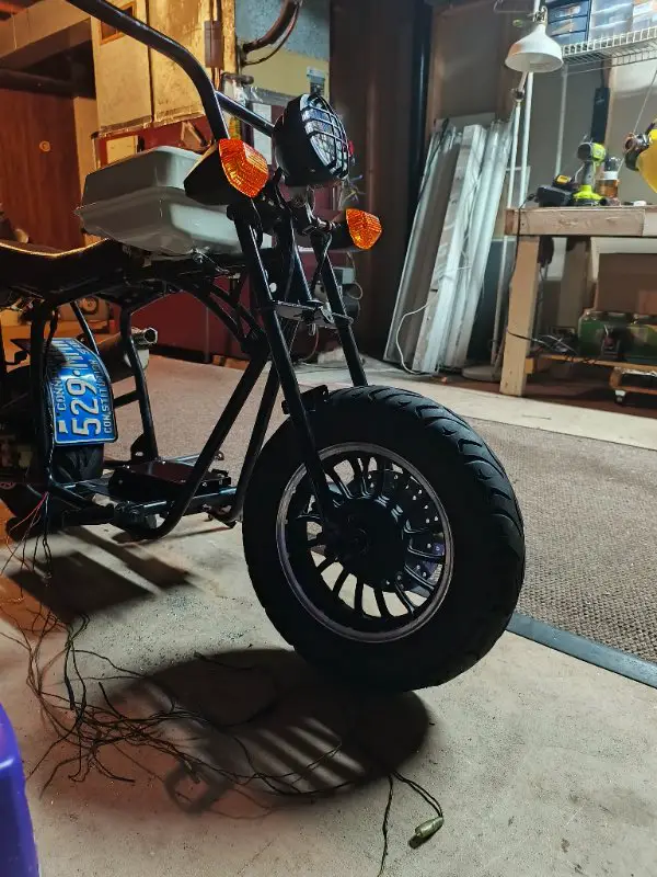

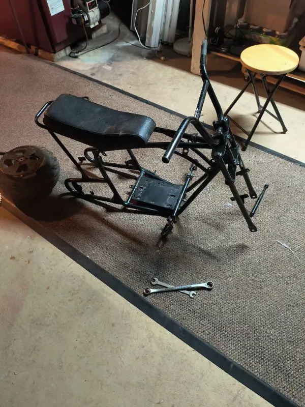

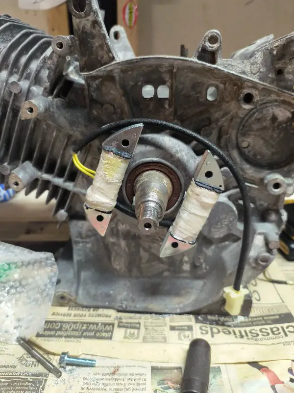

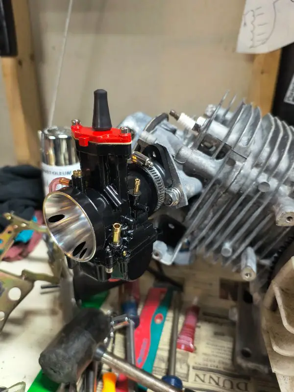

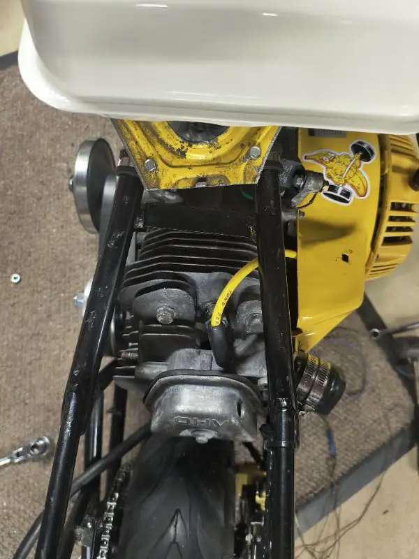

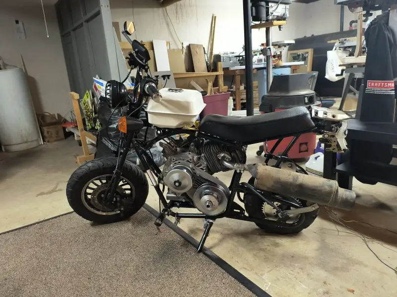

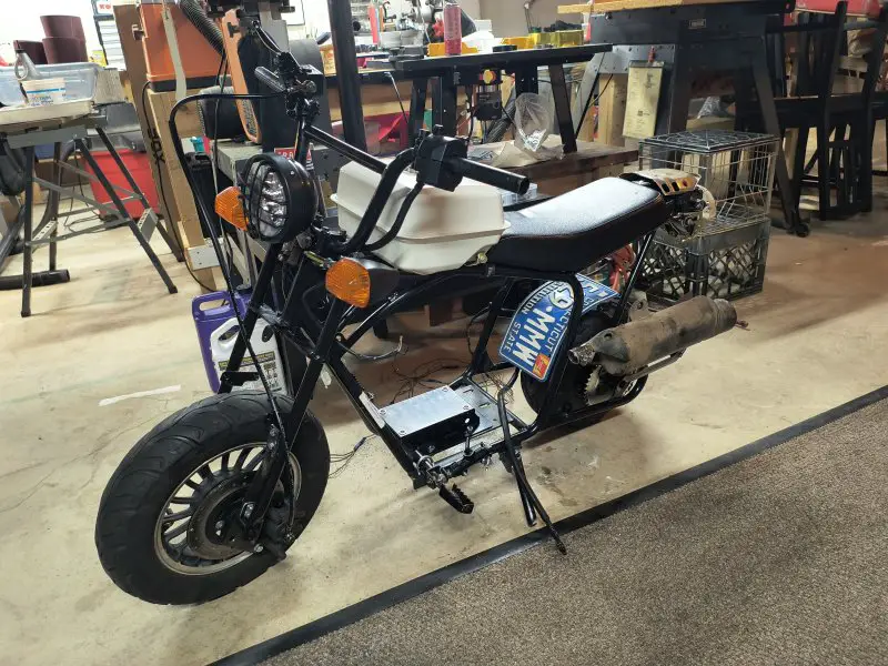

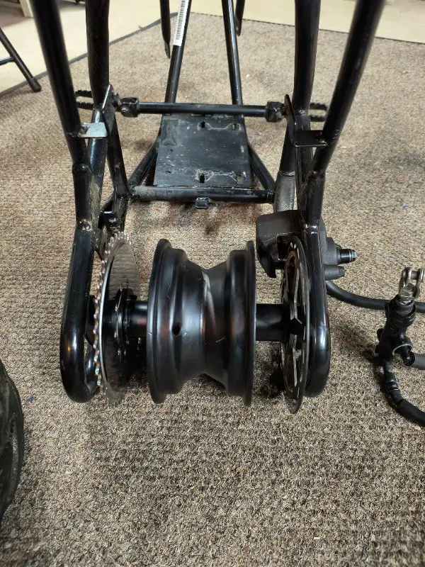

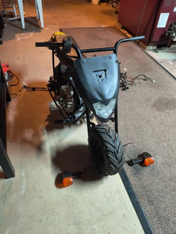

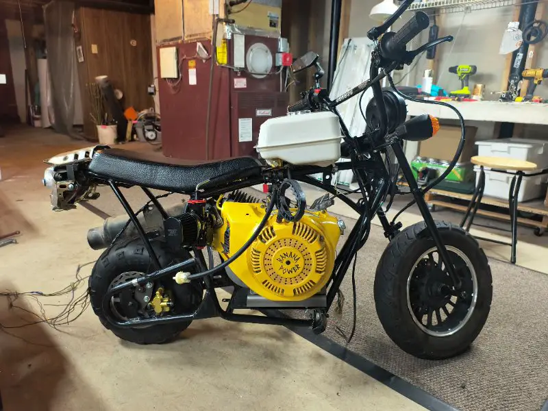

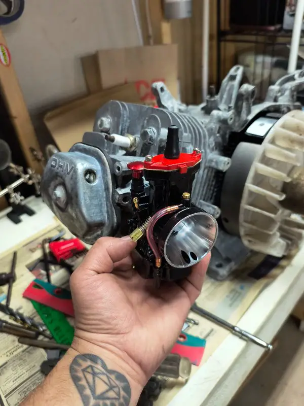

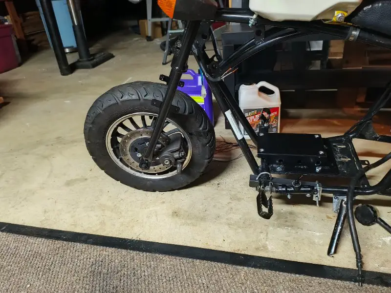

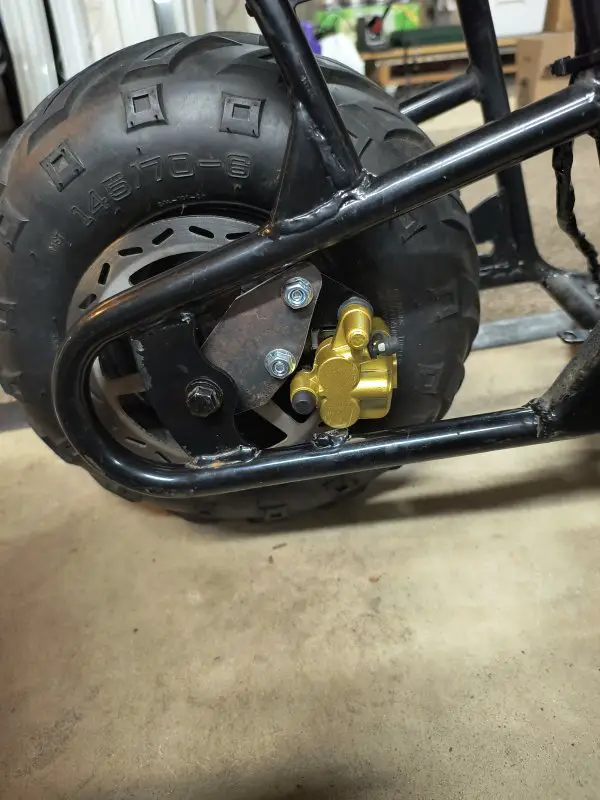

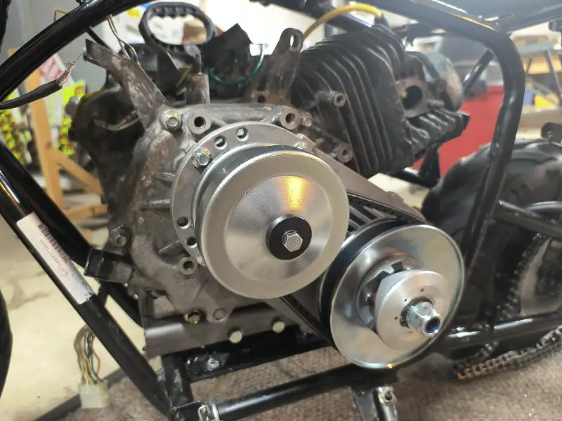

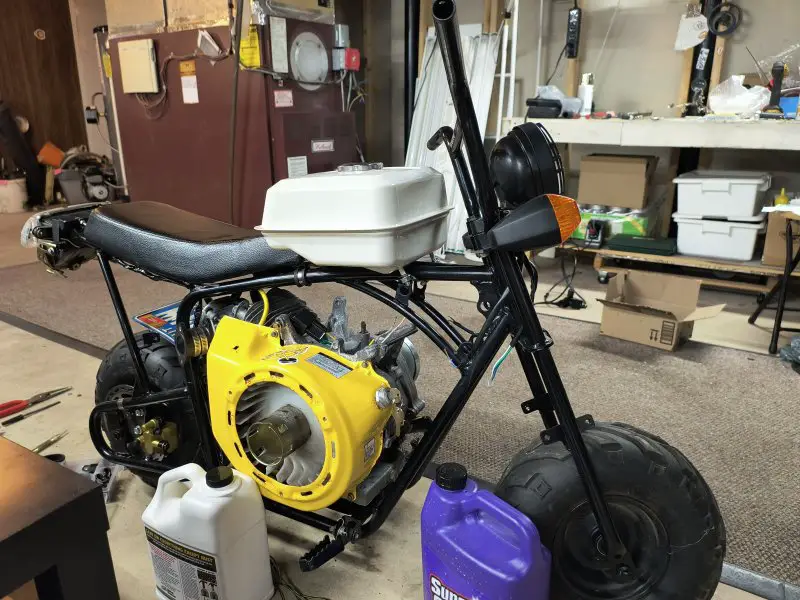

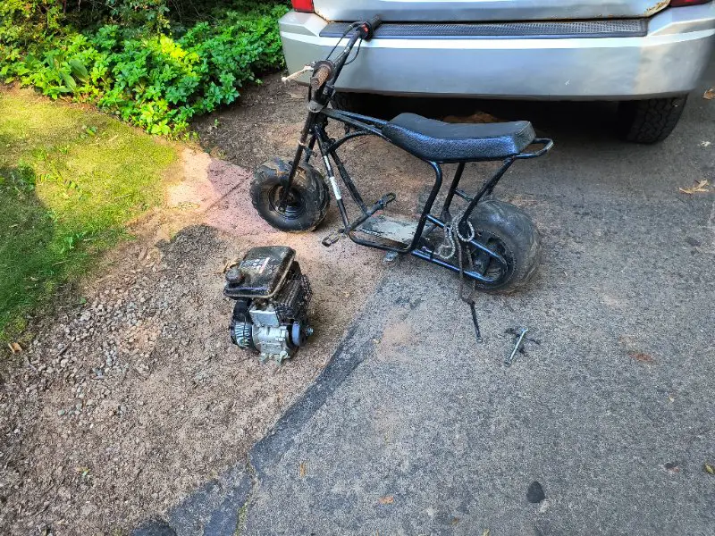

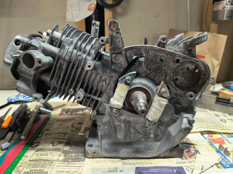

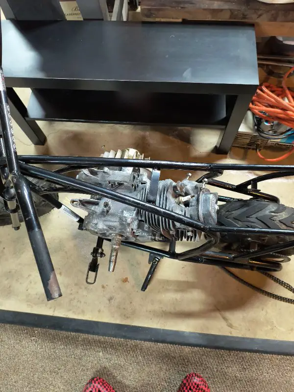

Hey guys. Hope your summers are going well. I figured this is probably the best place to post my new thread. I decided for my next build I'm going to make a street legal minibike, basically a homemade grom. In CT this is possible with a few headaches. I've decided to make my build conform with the state requirements such as lights and horn and whatnot. It's all starting with an 11hp 338cc Gx340 clone that I pulled out of a generator I got for free at the side of the road. I know the engine was running when I took it off because I tested it. I got a lighting coil for it that goes inside the flywheel and will generate 12v/2A which will be enough for a small battery to stay charged. I'm going to be using only LED lights so it will be low draw. I'm purchasing a 34mm mikuni style carb today and getting a header for it soon. Power will be delivered through a cvt to a #40 chain and sprocket set. I'm going to buy a roller frame for it that's more or less ready to motorize. I'll convert the brakes to hydraulic. This is gonna be fun
