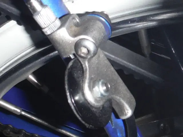

Who here can say what brakes work best for motoriized bicycling application.
I have just purchased and using a 70mm drum front hub brake that seems to work ok.
Maybe was expecting more but it still is new so most likely needs to get hot a few times and try it in city traffic and keep the cable adjustment tight for faster braking. Only have one brake on the bike at the moment. The front wheel brake hub. Still getting used to the hub brake using cable adjustments, removing all the slack makes it work much better as for stopping power.

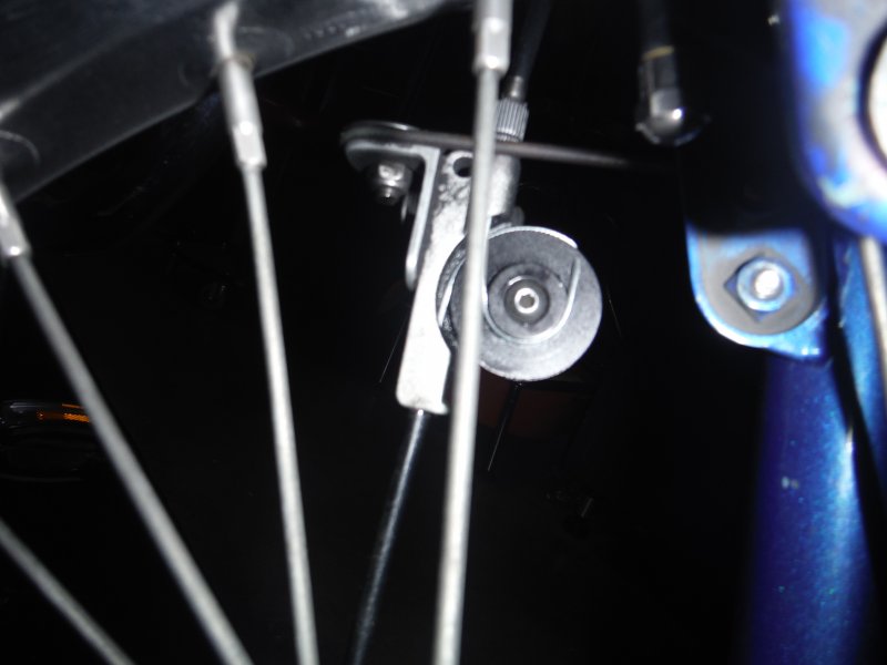

have had a few memorable moments with my sturmey archer, finally seems to be seating in now and braking improved.
Had the clamp break off 2x and had to make a new end and weld the brake arm end that snaps off when the clamp breaks. but as far as the brakes go the smaller 70mm drum brake works good after about 500 miles of heavy city use. next one will be the 90mm drum to try out, but I am happy with the braking now with the smaller unit.

ok checked it out, cool I need a beefier brake arm, and a better clamp for the fork to brake arm. broke 2x at speed already on me.

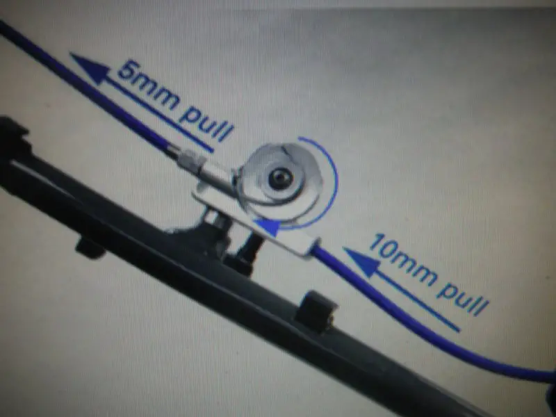

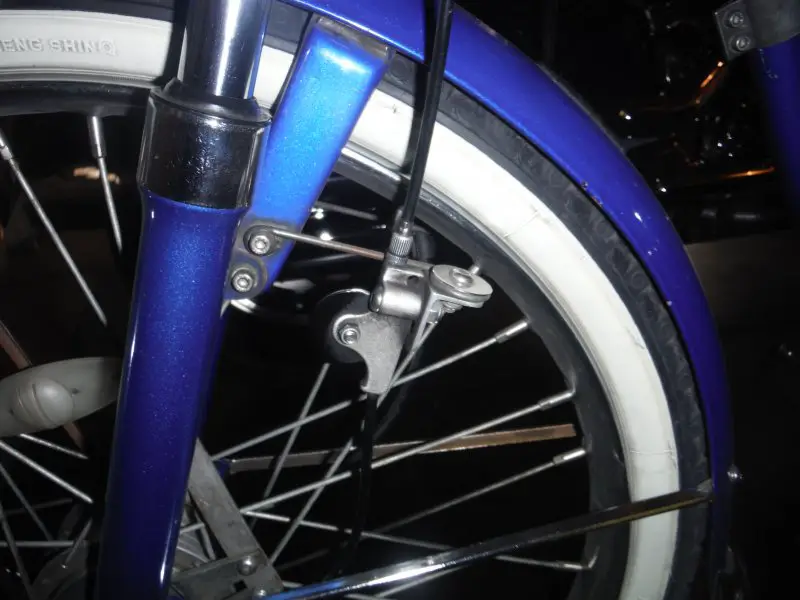

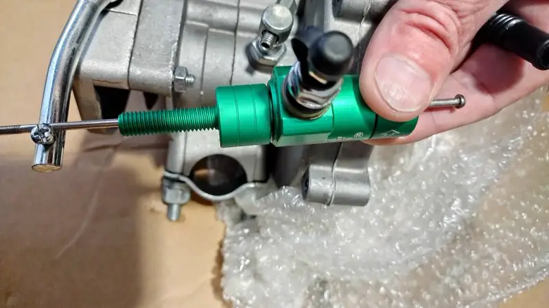

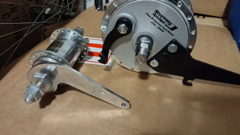

I used Problem Solvers InlineTravel Agents on my F&R brake cables
It allows you to get twice the cable pull
Yeah, these drum brakes require a little extra pull on the cable to get em to work really good
The cable is routed over a small pulley to a bigger pully giving you twice the cable pull
Some just use a hand lever that allows extra cable pull,
But on a Whizzer the hand lever is unique to the hand controls,
A little extra cable pull was needed. Problem Solvers Inline Travel Agents did the trick (^)
I made a flying mount for the front and I mounted the rear where a reflector was mounted
Whizzer Motorbike and Worksman F&R drum brakes 80mm
