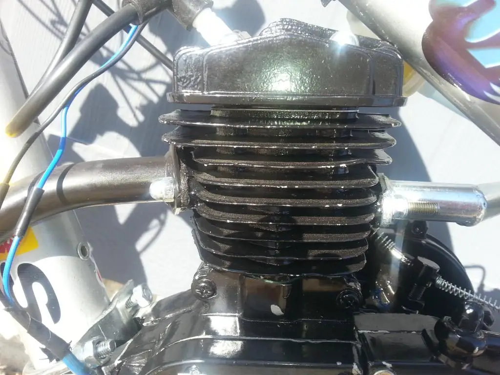

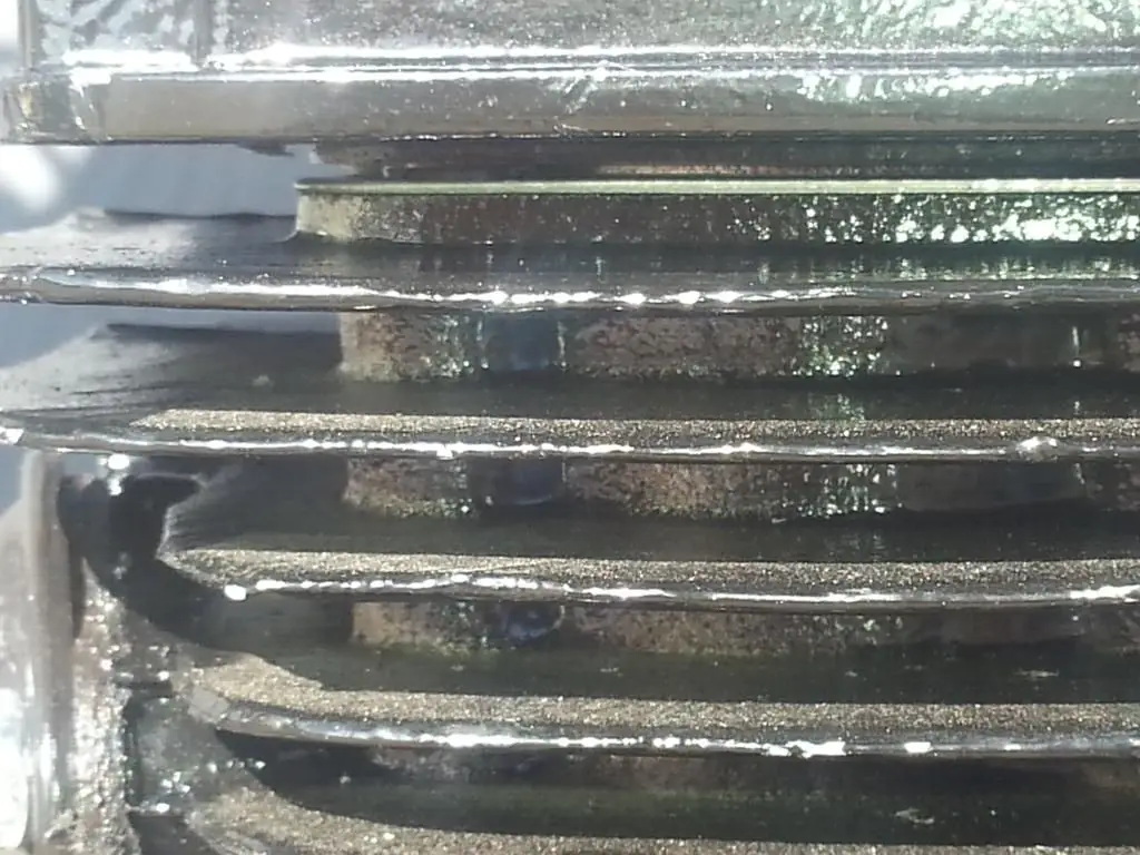

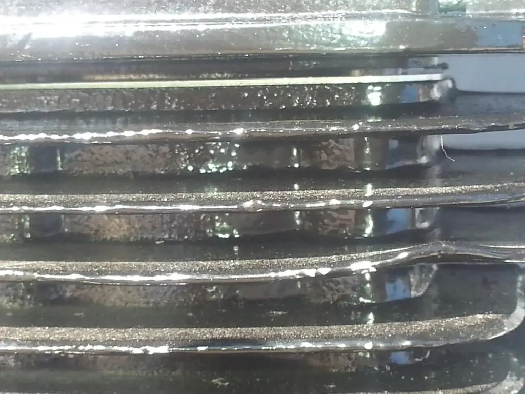

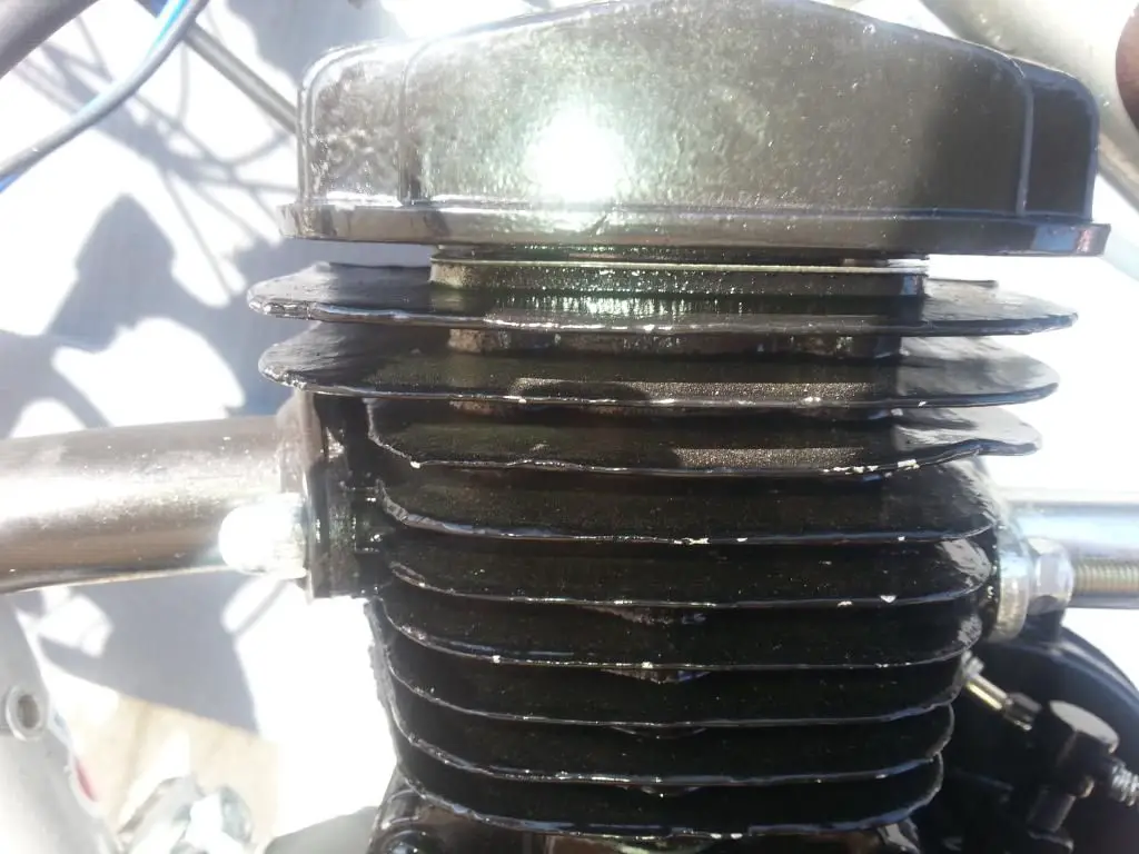

But, I noticed I felt exhuast on my calf, which is unusual because my exhuast points to the ground.
I noticed this
Have those acorn nuts as tight as they're going to go, I'm going to order new nuts so I can tighten the head flush.
I hope one of you tell me those is my problem all along
Take some very fine sandpaper and a perfectly smooth surface such as glass. Put the sand paper grit up and sand the mating surface of the head. That should fix the warpage.
DO NOT tighten the head nuts, "as tight as they will go". You need to buy or borrow a torque wrench. Those are only 8mm studs and nuts. Torque them to 120 to 140 inch pounds. Tighter than that and you'll probably twist the studs out of the case. Then you'll have bigger problems that you have now.
Also take the advice to 'lap' the cylinder head with sandpaper and glass to assure you have a flat gasket surface.
Solder those wire splices and protect them with heat shrink tubing. Get ride of the kit supplied spark plug boot. That's probably your problem now. Replace it with a good automotive quality boot and throw the kit one in the trash where it belongs.

if there is no leakage near the head gasket, then it isn't leaking
the slight air-gap you see at the gasket is due to a compression band molded into the head that increases the pounds per square inch on the seating surface
if you sand off this band, you will actually lose force on the gasket
