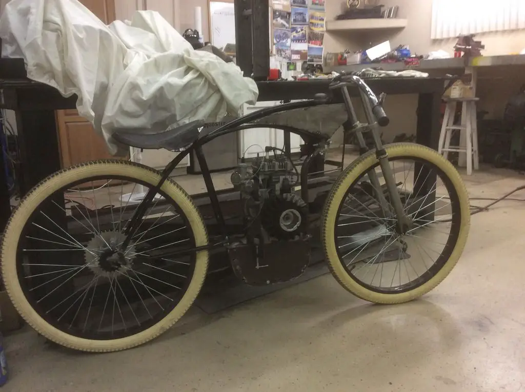

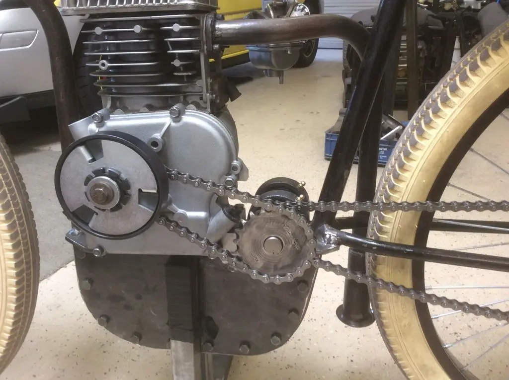

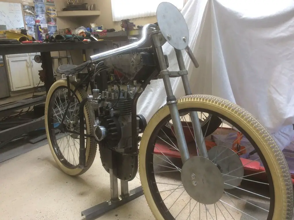

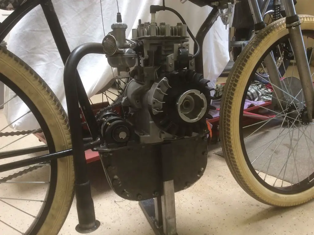

Well, I finally got the pic sharing thingy down through photobucket so I can start sharing my build. I decided to build a board track inspired build with a bit of originality. I figure I am building this project for me so I can do what I want! .....I sound like a little child! Here is where I started: the main frame is some type of 70s bike I think, I bought it from a guy down the road for 8 bucks. I modded the down tube and seat tube to open everything up a bit for the motor and jackshaft. The wheels and tires are off of a discounted Wally World bike. I am not sure about the front end, but I am pretty sure it is off of a late 70s moped. It functions great and was pretty easily fabed to mate up. I know it really doesn't fit period correct but WTF... I like it! The 5 hp flathead came from my friend who's son used to race karts back in the late 90s. The Briggs is slightly modded, cut head, mild cam, carb with custom manifold. i think I will pull it down and go .10 over, as the compression is lower than I want. Jackshaft is in the working, as I ordered parts to fab it yesterday.....damn I hope my gearing is close! I will keep you posted as things progress. Any thoughts or ideas are appreciated.
