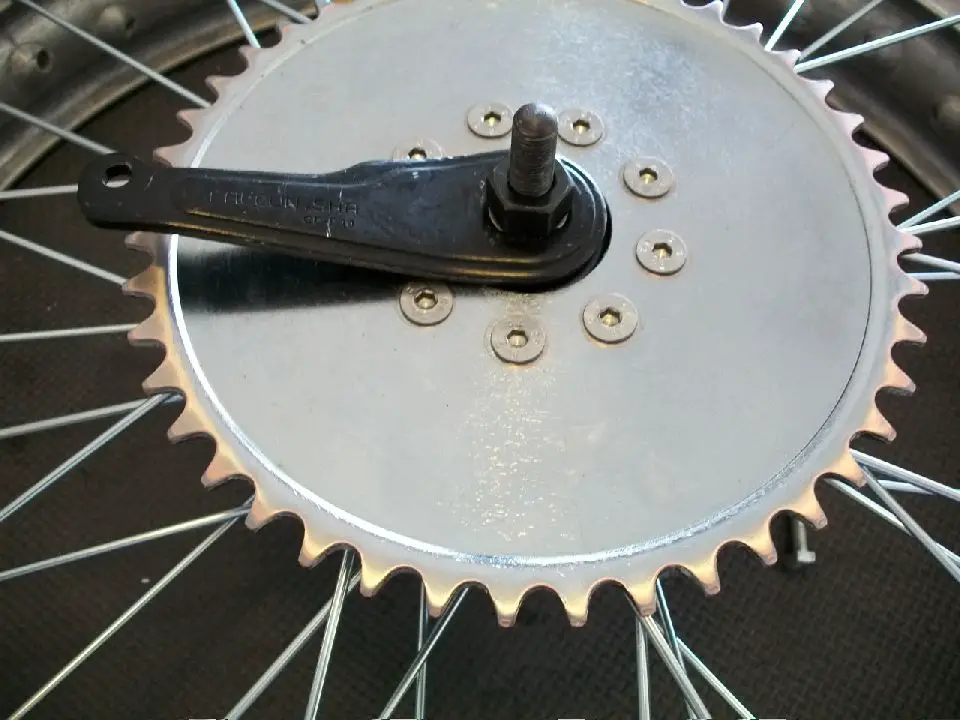

Now for the first impressions. The Bike: Have to really crank the handle bar bolt to get the handlebars to stay put. The front fender only has one rivet holding it together. Two drilled holes and some pop rivets sturdied it up. The rear coaster brake is pretty weak. The front fork flexes a lot. The frame seems short and seat height seems high. However,I had my eye on the Huffy because the tires,wheels and hubs looked much bigger than the other bikes. With the low price,I could make all the mistakes from learning something new without worrying too much. The motor kit: A marvel of ingenious design, the Red Bat Chinese 2 stroke! Clutch and throttle like a motorcycle. The sprocket lined up perfectly with the spokes and hub making everything concentric. I bored the sprocket hub to go over the hub bearing cover. Had to bend the brake arm, countersink and put in flat head screws on the sprocket for clearance.

I placed the chain sprocket on so the teeth face outward, away from the tire, to help with tire clearance.
dnut
Did u use both rubber rings on the spokes? If so how did u keep the sprocket flush on the hub retainer ring? Also, my clutch rod that gets pushed by the lever will not move in. R they known for getting jammed up?
I only used one rubber ring, that is what is recommended for coaster brakes. That way the sprocket fits tight around the dust cap and hub. My first engine kit, boygofast, was locked up. I had to take the clutch cover off and loosen up the star nut. Then the clutch was able to push pin in to disengage. Hope that helps. Search "star nut for clutch" and you will find detailed description with picture on how to do this. If these engine sit around to long they can get stuck in place or if the China man tighten it up too much.
