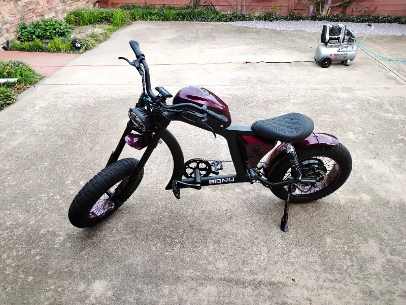

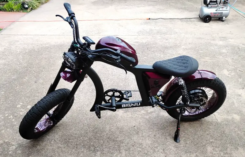

This is Bullwinkle, my new build. The donor bike for this project was a Bigniu BGX. It's one of the new generation high speed, low torque eBikes coming out in the last year or so. It wasn't too shabby in stock form, with a claimed 1500w motor, and 40 amp controller, which actually put out over 2000w. I probably could of lived with that but it had one major flaw. It's gear drive hub motor has too much noise coming from its metal gears.. Besides that, it's the best looking eBike I've owned. That makes it a prime candidate for upgrading. This is the most extensive build I've competed so far.
The first thing I did was rebuild the stock 48v battery, turning it into a 72v 20ah pack. I replaced the stock 40 amp controller with a Russian Thermo Nucular F24, adjustable up to 500 amps. I'm running 80 amp. The new motor is a no name ,but probably QS, direct drive 5000w hub motor. My goal was to keep the bike looking as stock, and turn it into a decent street bike capable of keeping up with traffic. I feel like I achieved my goal. Changing the settings is easy, but for now I'm running it at a modest 80 amp, 5000w good for about 50 mph.

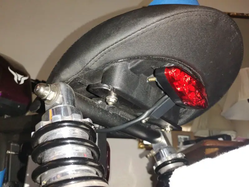

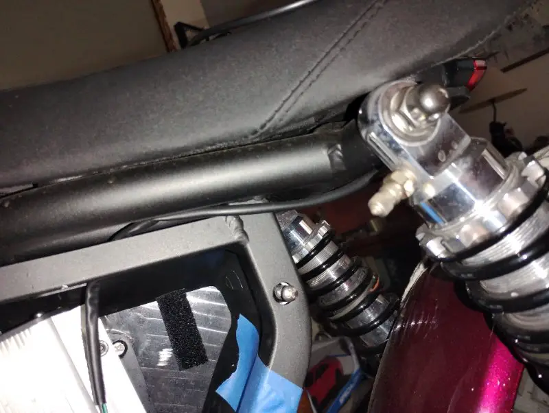

Would you be so kind as to post a couple pictures of the underside of your seat I want to put a bobber seat on my bike and I'm not quite sure how I can do that with no eat post cuz I don't want the post on there.

There's a flat 1/4" aluminum plate welded to the frame under the seat. The factory that built this bike did a good job on a lot of little things.

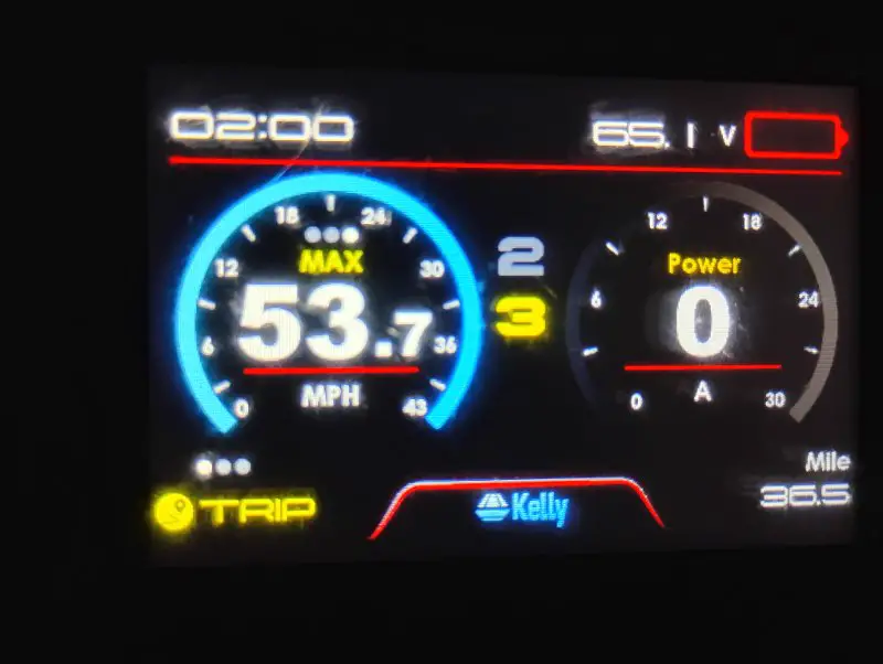

So I took it out last night and rode 35 miles through the city. Mostly side streets but some major traffic streets. My testing has shown that my battery is the weakest link. With that in mind I have the controller battery amp set to a modest 70 amp. Even at this low setting it's pretty fast. The BGX, which I renamed Bullwinkle, feels faster than the Stealth. Lsat night in traffic I got over 50 not trying .
