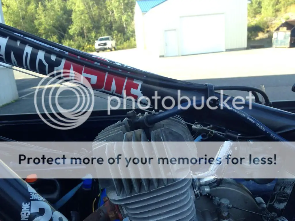

Late night run ends with a broken spark plug boot

Next morning I see the problem, don't know how but plain view broken boot housing.

Well off to OSH `or` Ace to see if they have any heat shrink tubing that will fit that spark plug boot
I replace the stock boots that come with the cdi with a NGK I get at the local motorcycle shop for about $3. Its made for a motorcycle and screws right on the wire, you are not the first to have a boot fail. Some auto parts stores carry them also, or you can replace the wire with a auto type that needs the adapter on the threads of the plug. If you replace the wire make sure the new wire has wire core, copper is better.
Throw that kit supplied plug boot in the trash where it belongs. Do as Greg said and replace it with one that will work and won't fall apart.
I prefer an automotive quality boot with a connector that I solder the conductor of my copper core wire to. These type of boots require a spark plug with the top cap installed which gives more surface area for a good electrical connection than relying on threads.
Nevertheless the boot that Greg uses is far superior to that piece of junk that comes in the kits. They are probably responsible for more engine problems that any other one item.
Guys Guys, Nooooooo. Thats Not the basic boot, That's a different boot all together. This is part of my Racing CDI from E-bay that cost me 50.00 for just the CDI unit. And I grabbed the basic boot and used it to get to the store. The boot I pulled off had a longer screw within the copper core then the basic does.

well what ever it was it did some serious damage to the boot. I'll contact netsharpshooter on Ebay and see if I can get another boot from him. He's the one that makes the Racing CDI units that have the pill bottles attached to them. That's what this is ..... And if need be I can send him the links to the video and the picks to justify his curiosity.
But does the engine sound like the piston is slapping the wall a bit much to you? It does to me and can't get used to that lol.
That's probably a screw on boot, hard to tell from the picture. It should come off, slide the rubber water proofing cover back and see.
