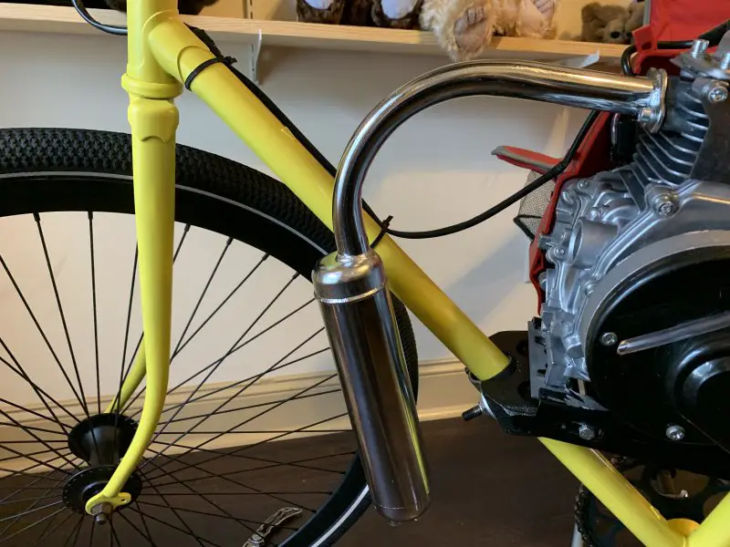

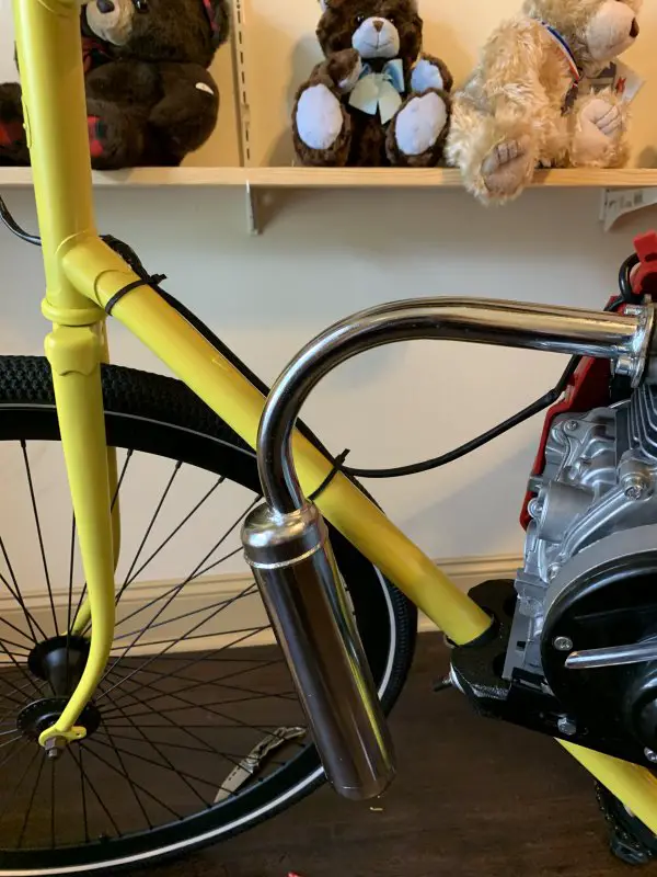

I have posted a picture of my problem. How do I bend it the muffler without damage? Muffler hits front wheel, cant turn right?

vkray,
Others will chime in I hope.
I cut the exhaust.
A, 1 inch stub at the exhaust flange and left a equal amount of exhaust pipe out of the muffler.
Bent conduit to clear, joining with U-clamps.. The guy I worked with a guy that got me motivated to supplant my longing for a Whizzer.
