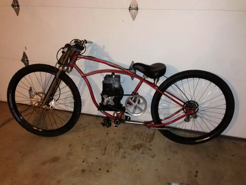

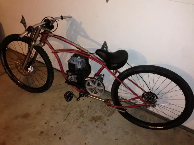

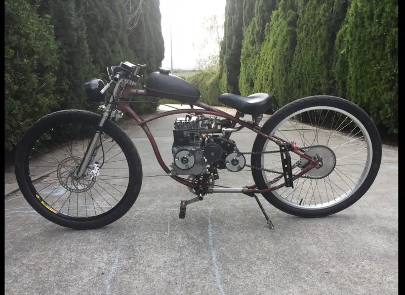

Most of these set ups I've seen went right from the CVT sprocket to the rear wheel. You Have a triple reduction with the belt and two chains. I would eliminate the jack shaft (along with all the extra problems it creates and the room it takes up) and go with a moped rear drum hub with bolt on sprocket. Your motor should pull it nicely once you get it tuned properly. Top speed would be improved also. Worse case you may have to purchase a larger rear sprocket. Bike looks great. Keep working on it and you'll get where you want it to be.
Just want to say THANKS to everybody that helped me out throughout this build, a lot of good advice that has helped me finally finish this project. Msrfan your Briggs builds have inspired me to build a great looking cruiser. If I have time I would like to fabricate a comp-release like you have as well. It's pretty much where I want it to be, runs good, fast enough, hopefully going to be a daily driver soon.
It's true.. two reductions are more efficient but just thinking about it gives me a headache. Would have to move the engine 2", buy more stuff, and delete the pedals.. I think I will save that stuff for my next build. This one is running ok enough and I'm reluctant to make any more major changes.. will just try to make it run the best I can with this setup.
A previous two-reduction setup I had that worked was the manual belt clutch. 30mph with 11.67 ratio. Paired with an IGH? Pros: lighter, efficient, smaller package. Cons: less shift ratio, hard maintenance, not CA legal... hmmm..
After the ride I moved the right side bearing to the left 1.5" for more drive sprocket support. Way it's setup takes a good bit of fiddling to get good bearing alignment. Dished wheel/moved sprocket and ditched the rear tensioner. Eliminated drag significantly and will test tomorrow. Inspiration for this setup comes from scotto's builds.. first time I saw that, I thought.. I wanna build that!

Well, the first thing I did was test it on a hill. Maybe it's a combination of factors, but the bike did not want to go up the hill. Halfway up, the CVT started smoking. That's when I shut it down.
I don't think the CVT cover helps with cooling very much, but it does help my left leg. I'm not really sure what to do about this. Any holes I cut in it will look very ugly and may compromise the strength of the cover. We'll see.
The bike runs much worse with the crappy muffler. My top speed of 40 is now 35, or maybe 30.

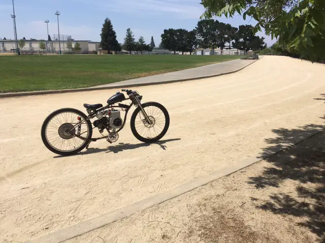

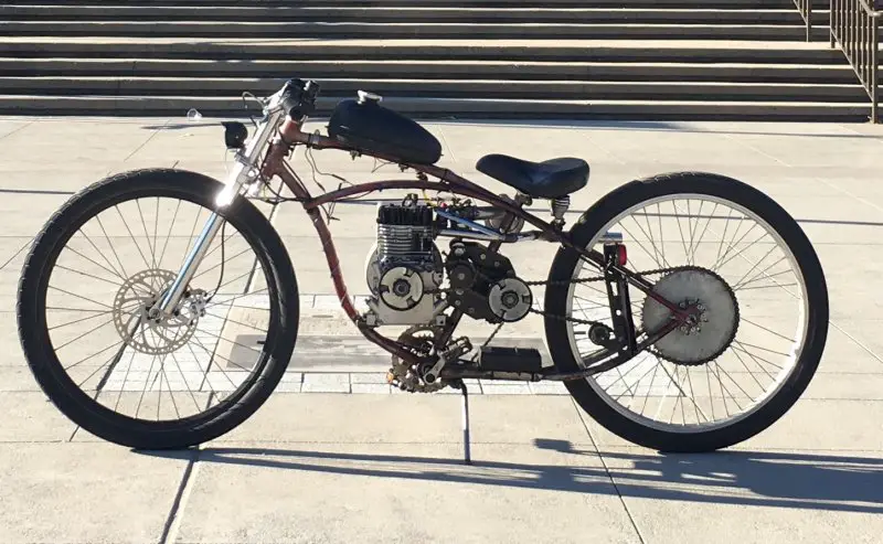

It's done!
Well, the 1980 Chicago Schwinn with Briggs 3.5hp flathead is DONE.
Did the valve work and put it back together. Since then, have ridden almost 75 miles on it yesterday and today, and most of the problems have been worked out.
This is a big thing for me, because I've got a long history of starting projects that never get finished.
The major parts of the build that have been, or have not been, figured out-
Registration: Mailed the application for the moped plate today. This makes completion official.
Drivetrain: The bike maxes out at 32mph on level ground in 92deg F heat, and 36mph in 70deg F. The Comet knockoff CVT engages at 2100rpm and governs shift and max rpm at 3300. Downhill I managed 43mph in 92deg weather. Within CA law of 30mph on level ground.
Brakes: One brake, a front 203mm disc rotor with Hayes Stroker hydraulic caliper does the job. Disc gets warm after a normal stop from 30mph. Takes a LOT of hand force to stop quickly.
Gauges: Cheap digital tachometer hooked to the kill switch wire and a cheap bicycle computer, which is configured to tell me time, temp, odometer, trip time and distance, instantaneous speed, average speed, and max speed.
Wheels and tires: The cheap setup works. 36 regular size spoke wheels, $25 rear junk wheel with rag joint sprocket, Kenda Kwest 26 x 1.95 tires at 45psi. Good on asphalt, just OK on dirt. Not spectacular. Will do burnouts on pavement.
Comfort: No shock absorption leads to a rough ride. Becomes noticeable after 5mi, need to start taking breaks every hour after 20mi.
Lights, horn: None as of yet. Don't ride at night. Too cold! :)

Thanks to all who helped me along this path. I finally finished a project. It seems bike projects are the only ones I finish. This one REALLY started back in early 2013. It took 30 months to finish!! But it sure as heck doesn't look like anything else out there.
All up cost is $800 for all things currently on the bike including the $20 registration check mailed today. I won't even count all the failed attempts. I will sell all the parts I don't need to try to make up for all the failures.
