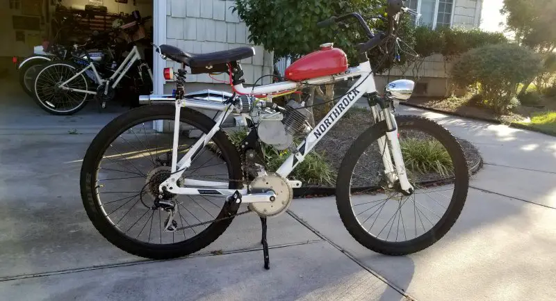

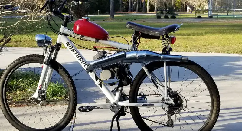

Hi Measure Twice. I have so many spare parts it's hard to keep up with them, but I seem to remember the stainless chain came from an OCC. My 412 and 415 KMC chains, including the stainless ones, were ordered online, probably from Amazon. Anyway, I've nearly completed the new Northrock enduro build and thought I'd throw up some photos. It's pretty basic except for the electronics box under the seat that holds the CDI, rectifier, fuse, and toggle switch that will soon be switched out for a key. I used a standard 4-wire trailer wiring harness from the engine to the electronic box. Blue wire from magneto to blue wire on the CDI, white from magneto to A/C input of the rectifier, yellow from generator coil to the other A/C input of rectifier, brown to black wire on CDI, and green to ground on the rectifier. The rectifier feeds my LED lights from a generator I bought on Ebay but had to rewire after I found two breaks in the wiring. The bike is very light and fast with 7 gears to help the stock 66cc Chinagirl. The 1st generation SBP shift kit and Shimano gear selector works like a charm. Shifting up is a breeze, smooth and seamless, with the spring-loaded push button, but it took a while to get the hang of the thumb lever for downshifting. Had to lengthen the brake cables to the dual brake lever to fit new handle bars. The fabrication of a fork stop to keep the front end from jack-knifing has been pre-empted by the holidays. Will be looking for some long trails next week. Might install minimal plastic fenders to keep everything dryer. Any recommendations? Happy Trails.
