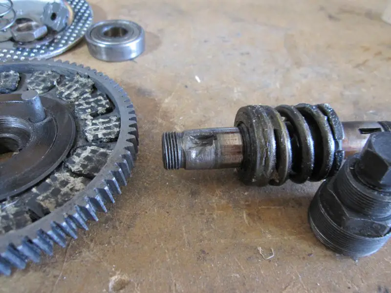

gill vanderwerf Active Member Sep 9, 2019 193 88 28 63 Jan 22, 2020 #1 i want to order a replacement clutch set to maybe try and fix that new 66cc motor i have just wondering if they are universal 1 firs all? Reactions: indian22
Greg58 Well-Known Member May 1, 2011 5,359 2,584 113 66 Newnan,Georgia Jan 22, 2020 #2 Gill this set might be worth a try. https://www.bikeberry.com/heavy-duty-high-temperature-clutch-friction-pads.html Reactions: indian22
Greg58 Well-Known Member May 1, 2011 5,359 2,584 113 66 Newnan,Georgia Jan 22, 2020 #3 Some of the early Grubee engines used oval pads, the pads I listed should work with newer engines and can be shaped with a grinder to fit the Grubee. Reactions: indian22
xseler Well-Known Member Apr 14, 2013 2,886 151 63 OKC, OK Jan 23, 2020 #4 I had a Grubee Skyhawk 66cc. I had to 'trim' the pads slightly to fit the holders. Yeah, I also had to replace the shaft ---- also had to narrow and reshape the key to fit the new shaft. Good luck in your adventures!! Reactions: indian22 and Greg58
