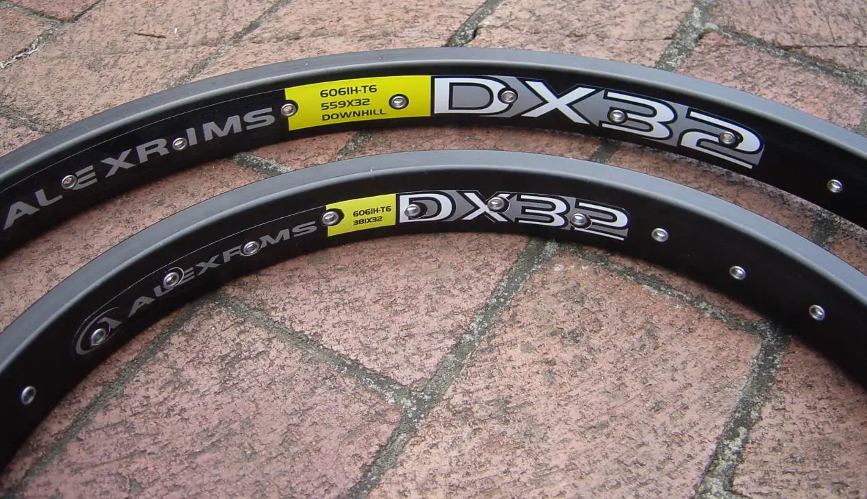

The Weinmann DH-39 is very similar to the alexrims DX32 in construction, the companies are very similar too from what I've seen of their products. I've a set of three DX32s on my taddy (26" & 2x 20"s) which is a somewhat heavy build and I've been very impressed with the durability so far...
As for disk brakes & custom wheelsets it's often easier & even sometimes cheaper to buy just the rim & lace it (or have it laced) to a hub/brake of your choosing.
Hope this helps you a bit ;)
