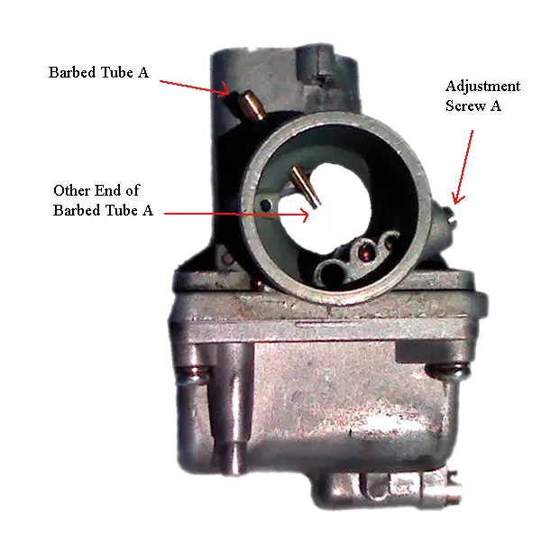

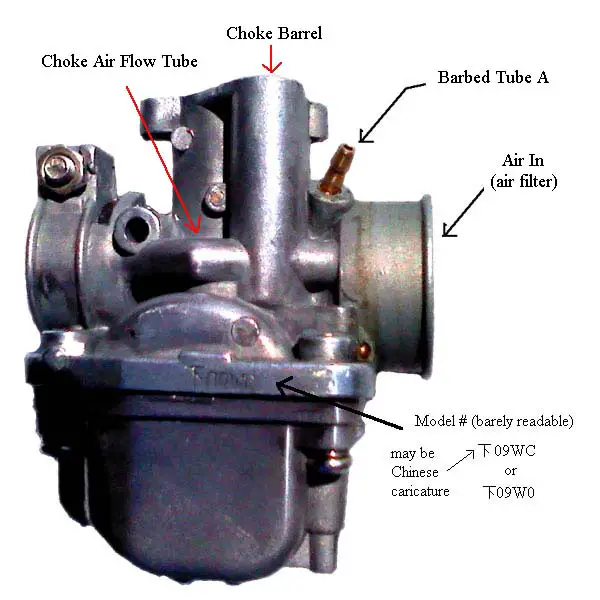

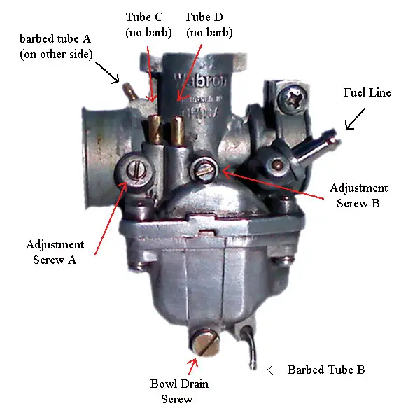

Any help identifying this stuff would be greatly appreciated
So far input has been that "barbed tube A" connects to "barbed tube B" for the choke enrichment
- I'm not so sure about that...the choke barrel has it's own hole into the bowl and a venturi tube from the filter side of the carb throat, passing over the choke hole then out the engine side of the carb throat which would draw fuel out of the bowl when choke is opened -
If I were to guess I'd say "Barbed Tube A" might be for a Boost Bottle.
Tubes C and D are just vent tubes.
I'm guessing "Screw B" is idle speed adjustment.
I think "Screw A" is a fine tuning mixture screw for the idle
P.S. I have "barbed tube B" bent down so it will clear my shift kit bracket and the top of the throttle tube where the throttle and choke cables attach has been removed.

Well to me, that looks to be the air/fuel adjustment screw. Screw it clockwise for leaner (more air) CCW for richer (more fuel).

Yes, got it running last night but by the time I had it all together it was too dark to play with it. Got to mess with it today for a while. Had to find the right groove for the needle clip (all the way at the top) and she ran like a top.
Yes, the screw closest to the filter is the air/fuel adjustment screw. Took be back to my old Briggs and Straton lawnmower days. Got the idle dialed in. I think the air/fuel adjustment screw might have an effect at different throttle positions too. Gonna have to mess with that later.
Still no clue what the barbed tube at the top by the air filter is for. I've just capped it off with a rubber vacuum cap. Cap on or off doesn't seem to make a difference. So it's capped to keep dirt out.
Still no clue what the barbed tube at the top by the air filter is for. I've just capped it off with a rubber vacuum cap. My right shift kit bracket's also in the way, can't get the carb to sit level. Gonna have to make a shim for the intake pipe.

Took my bike out for a nice looong ride today. Carb dialed in for an excellent idle.
But...theres no tickle button on it to prime the carb and I had to pedal much too far to get the engine to start. Also, I think it runs too rich for these china engines. I have the needle clip on the highest groove but the bike just won't wind out like I'm used to. I messed with the air/ fuel adjustment screw and it does have an effect on the full throttle range performance. The engine does have some decent low end power but once it's at half throttle it starts bogging down and at full throttle it starts sputtering. Gonna try to fill the jet and drill a smaller hole in it to see if it helps.
My Opinion: It's a nice looking carb, nice looking air filter, lots of bells and whistles on it but out of the box as it comes when you buy it, I think the stock carbs work much better...
Hey man I have this carb and it can work great if tuned right. For sure your problem lies in your main jet.... probably too big. I had the same problem but low and high after port matching and changing port timing.U can go wide open press the kill switch and then clutch to a stop and check your plug.If the plug is black vs light Grey then you need a smaller or leaner main jet if it is white it's too hot and not getting enough fuel but I suspect it's too rich.Main jet kits for dellorto carbs work. M6 thread or type? . As for low jet u sound d like your fine and I am still trying to find the correct jets for this think I found but am waiting for them to be delivered. Should have looked at the date lol
