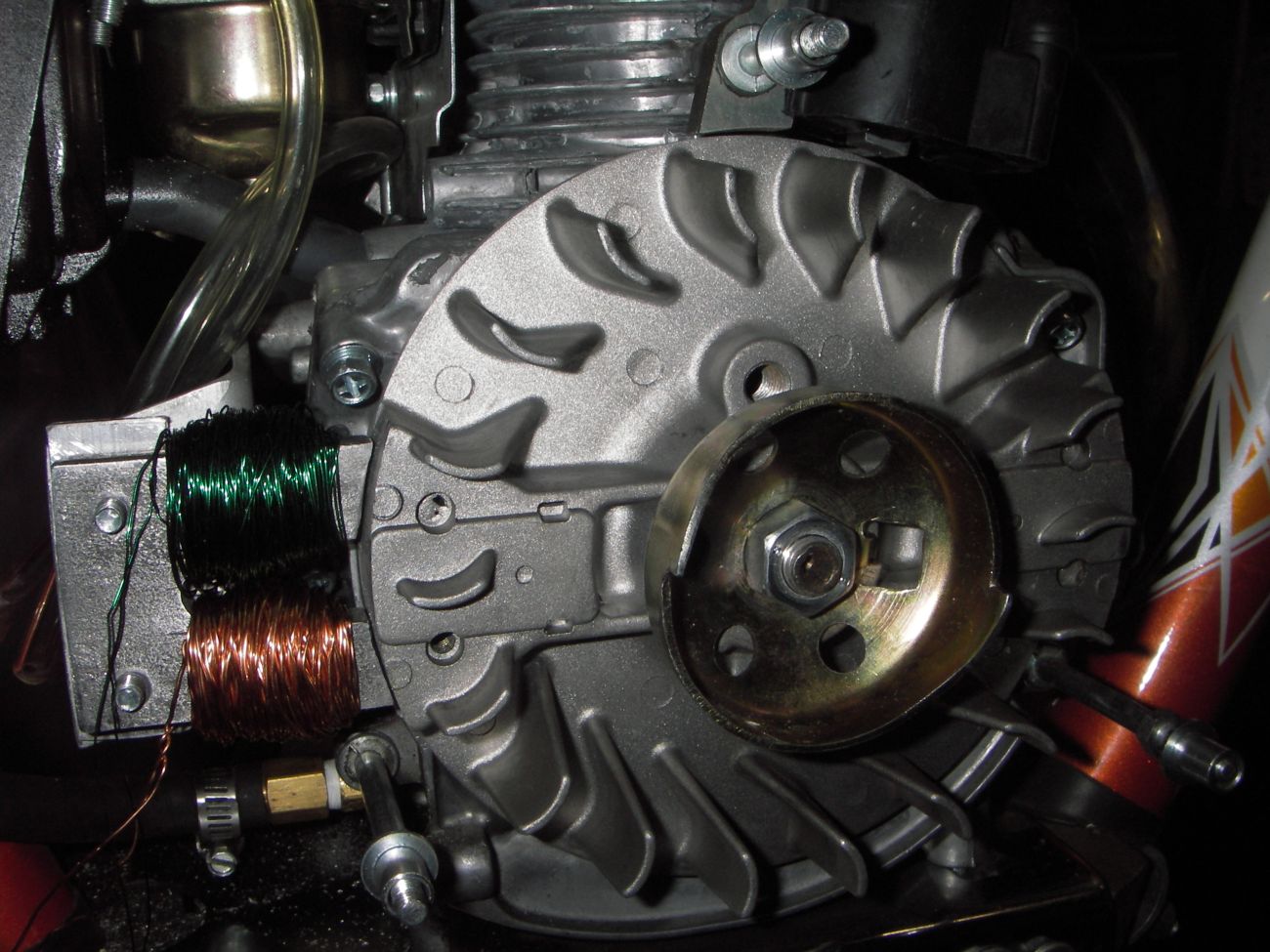

It bolts on under the air filter , there's 3 mounting lugs that work perfectly! That is a 12V magneto and I use it to run the head light and tail light.

Low and behold we find out Phantom Bikes paved the way with a bolt on solution for the 142!
Hats off to them!
It's a couple of coils and a regulator.
* Msiert's pic enlarged, thanks for sharing.
One big Stator coil would work, they used 2 smaller ones.
On lager engines like this one for a Honda 125, the stator has a series of 8 of these coils around the rotor magnet for tons of power like this.
The more coils you have, the more power it makes (and drags the engine) as the magnet spins around inside it, that's why don't see them on little engines, the Rotor magnet is on the outside of the flywheel/cooling fins for the CDI's magneto only.
All that is needed is just a Stator coil or two like Phantoms and a 12V AC/DC converter and regulator mounted where the magnet with spin.
This looks like as good as any place to find stator coils and 12V AC/DC converter and regulators.
http://www.rickystator.com/
A 75W coil or two like this for ~$55 should do the trick.
This looks like a fair price for a 12V regulator/rectifier for ~$55 as well.
75W / 12V = 6.25A max output current.
You'll never see that, there are losses at the regulator and RPM's will matter some, but you should be able to count on 4-5A regardless of RPM, at least as long as it's enough to make it into 12C DC.

unfortunately none of those rickystator has will even come close to working on the 142f.
maybe with the right type of stator(outside the flywheel), something may be made to work. but I haven't seen one yet except for Phantom Bikes copy of abikers rig.
This reg/rect works just fine no need to spend $50 for something meant for a 650 motorcycle. building one yourself cost about the same $4.50 for parts from radioshack, without being in a housing already.
http://www.ebay.com/itm/Voltage-Reg...Go-kart-JCL-/121441210733?hash=item1c4675d16d
the coil i made from a two cycle magneto and rewound just for lights only produced 8.5 volts Ac - so only 1 stator coil Will not work, it has been tested by many, only good for 6 volt lighting. for 12 volts there Needs to be more than just one coil winding, mainly because the magnet on the flywheel isn't strong enough,not a high enough Gauss, again tested and proven by a few. abiker and Phantom bikes and a neighbor of mine . in my posts are the parts I used.

The 49cc HS 142F engine you have does not have a power mag, but I'll bet you could attach one right next to the spark mag.
I will bet he knew that and that is why he started the thread.
"An external bolt on mag, clever and easy but not really efficient, for max efficiency you want the coil as close to the spinning magnets as you can get with nothing in the way like an engine cover.
There are plenty of uses for that mag, you just need some basic electrical skills to pull it off is all. "
