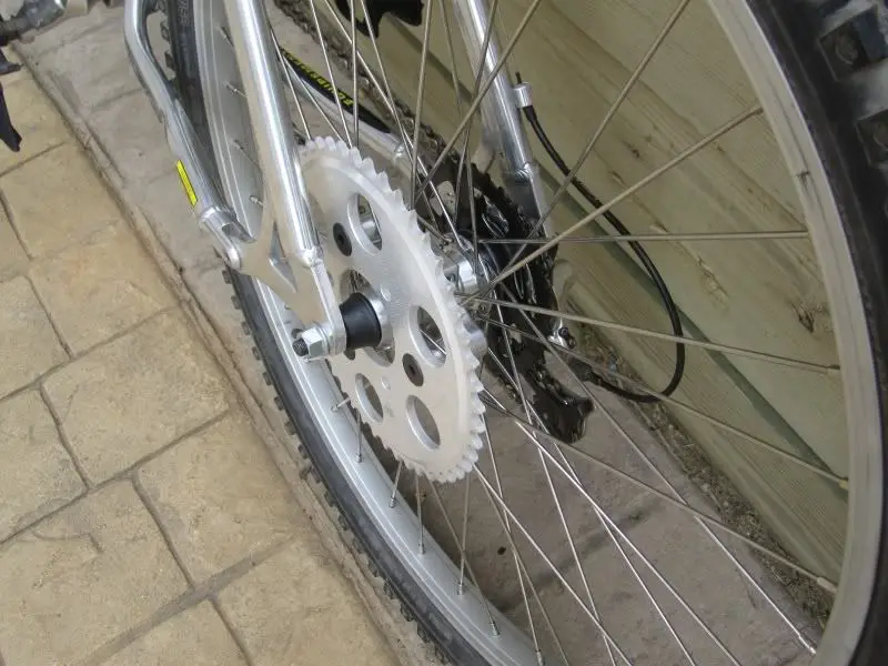

Hello all,

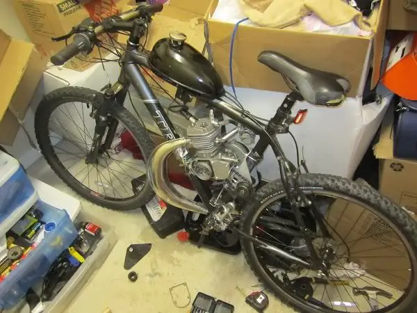

Been in the hobby for a little over six months now and loving it. Had my first build stolen 2 months ago

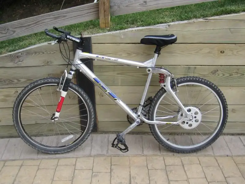

That threw a big wrench into my fun. I had just gotten finished installing all sorts of goodies like a boost bottle, centrifugal clutch, shift kit, etc.... and finally had the CNS carb running beautifully after putting in a new main jet. Good thing was that my renters insurance covered most of everything that was stolen from my storage and I am on to my next build. Been reading and getting lots of great info from a few forums, so I wanted to extend my thanks to you veterans out there that help us newcomers to the game. I'm working on my next build and here is what I have so far. I decided to up the ante and go big on this one.
GT LTS Dual Suspension MB (26" wheels)
KTM 50 clone Engine /Dellorto Carb (9hp) (ThatsDax)
SBP Expansion Exhaust (SickBikeParts)
Pre-Built Rear Rim w/48 tooth Sprocket (PirateCycles)
(Thank you to all these great companies!!!!)
Open to any advice or suggestions since this will be my first high powered build. Looking forward to it!

Those LTS frames have funky geometry, but it looks like a good start to a new build.
How'd you like the short expansion chamber? Just wondering....
Anyway, good luck on your new build. :)

Yeah, the geometry is perfect. I remember when they came out in the 90's I was not too fond of the design. Funny now that I have an application for it I love it lol.

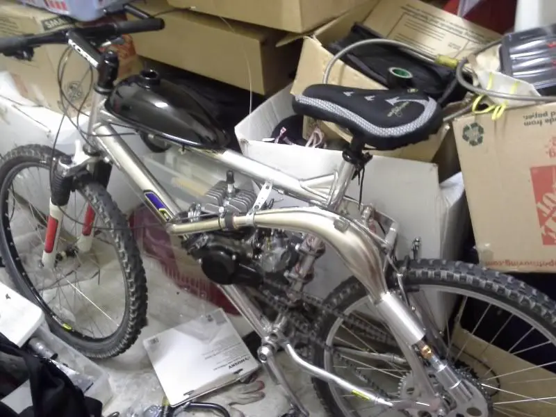

The expansion chamber was great. I definitely felt a difference. I had better low end response and it increased my top speed. The only thing I wasn't too fond of was the placement. If I could do it over again I would have modified it so that it was placed differently to give it a sleeker look. Still, overall I enjoyed the performance gain.

No, it it was an all around improvement. It also gives your engine a nice sound without blowing out your neighbors windows.
I think I purchased it from Bikeberry, but I have been having a lot of problems with them lately. Everything I order has been out of stock and you can not tell from the website. Sickbikeparts sells an expansion chamber exhaust, which I just received and you can adjust it to your liking, and they ship the same day depending on when you put your purchase order through. I prefer this one to Bikeberry's. It is also sold in chrome as well. They also update their site daily, so you don't purchase anything that is out of stock

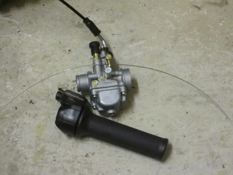

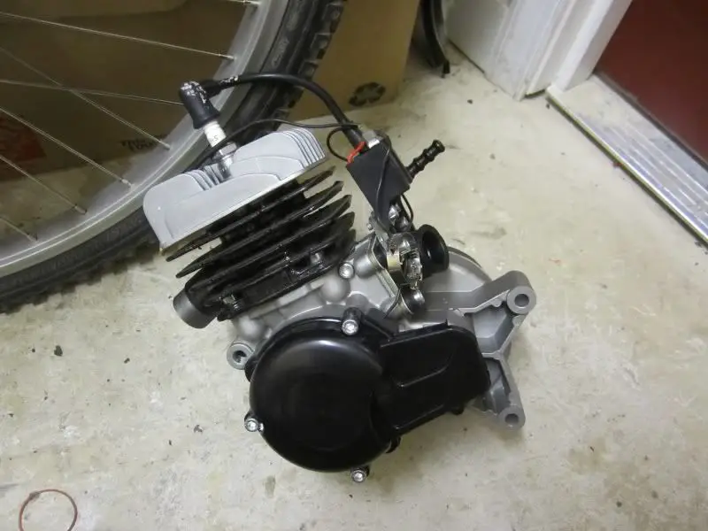

Engine starts, but the Jet size is a bit large I think. I ordered new Jets, so hopefully that's my problem. Will definitely get some videos up once she's running at her full potential. I am loving the expansion chamber from sickbikeparts.com. It comes with everything you need to attach it to your liking. I ordered extra silicon tubing as well. It came in handy for my mounts and for connecting the piping. I also got the silencer for this build. I'm sure I am sacrificing some power, but as of yet I am not sure how much. I'll fill you in once I know more.

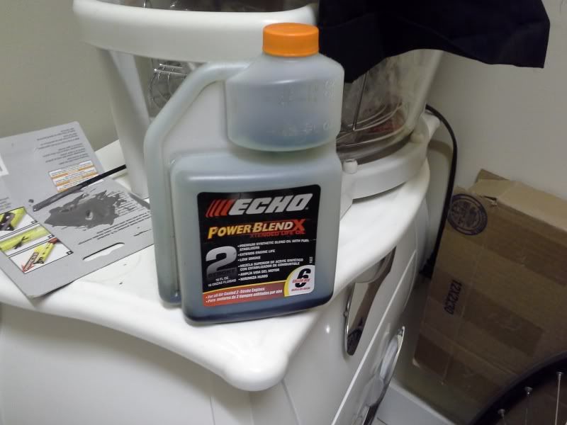

I was running 30:1 I believe. For each gallon I was putting in 4 ounces of 2 stroke synthetic oil. Here is the brand I was using. I bought it from Home Depot. There may be better out there, but it worked great for me:
I was having a ton of issues with the stock carburetor. I found a ton of air leaks, but once I solved that the 65 Jet worked great. 70 also worked, but I still had some 4 stroking at full throttle. The boost bottle helped smooth out the idle and helped the low, mid, and full throttle response.
