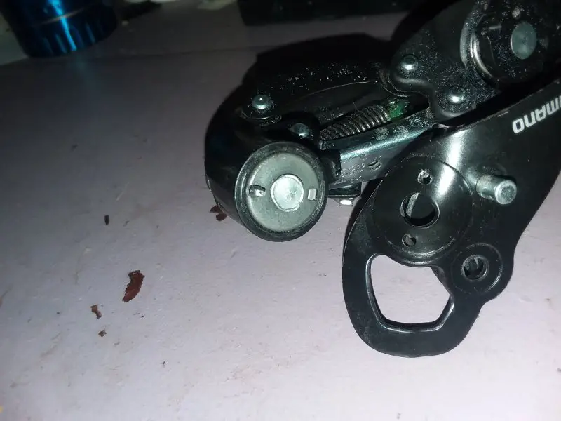

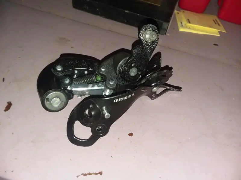

Well went to pay my rent yesterday. As I was leaving the post office with a money order the Shimano Tourney M300 rear derailleur came apart. Jockey pulley arm came lose from the derailleur body. Had to push the bike three blocks to my landlord's office.

Went and got the bike from my landlord's office today took some old chain with me. Did a single wrap around a sprocket and chainring made it home doing 5 mph. Better than pushing lol. The Shimano Tourney M300 was destroyed. My Shimano HG71 chain had several twisted links. Didn't appear to be any damaged cogs or chainrings. So shift kit builders if your rear derailleur has a lot of plastic in it be ready for problems.
I initially thought the Shimano Tourney M300 rear derailleur came apart from inside of the plastic knuckle that holds the jockey pulley cage axle. However, it was the axle that came lose from the cage.
