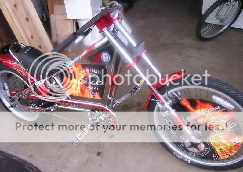

I'm Doing this same build right now. And i had a problem with the minimum leg room. So my brother cut out some brackets to extend the back wheel by i think four inches. But you have to move the brakes back for it to work. Makes A huge differences and I made a custom leather solo seat occ style. Which is way more comfortable then the regular seat. Heres all the photos of it Chopper pictures by SlipEagle - Photobucket.

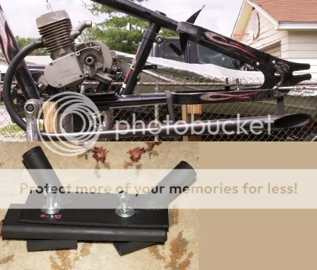

where can i find that mount i have googled it and binged it and all i can find is this pic of it ? any link would be gr8
I prefer to use Jim, @ Pedalchopper.com for all my Schwinn Stingray Motorized Chopper part's!
This guy Pedalchopper, has some Super High Quality products, and yes check his website for the Engine Mount, which come's with a Drag Pipe the is specially designed for the Schwinn OCC Stingray Motorized Chopper Bicycle's, see link below for the Motor mount & Drag Pipe, sold as a complete package!
