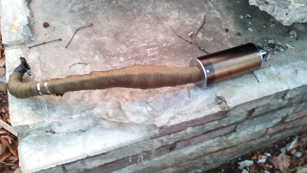

Still need to weld a brace on the frame for the scooter muffler its zip tied on

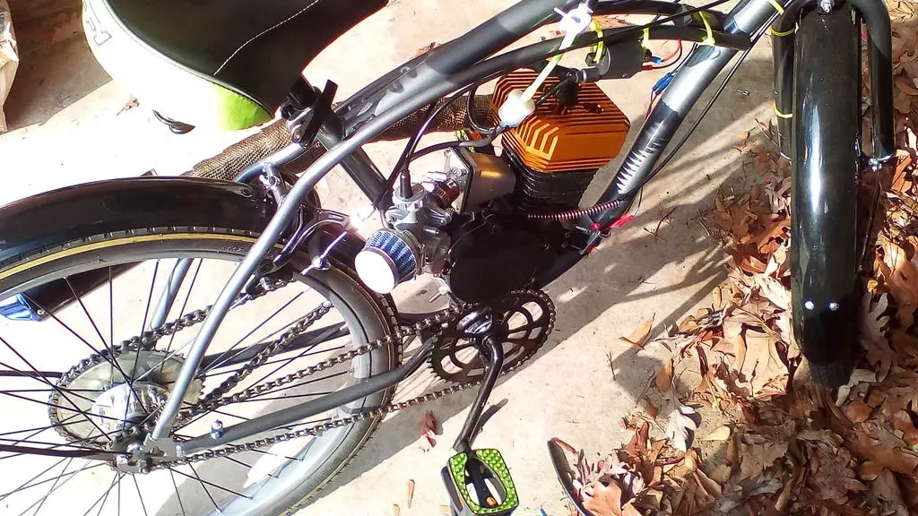

The head showed up yesterday but the spark plug was way to short got a NGK Bp5es longer reach but still I little short
Anyway here is a pic raining so not going for a ride

Probably a good thing it was raining..........you need to re-install your new head 1/4 turn. The fins need to be going the same way as the frame so air can more easily cool the head.
Best of luck in your upcoming adventures!

Thank you. Fixed the head problem some more parts are due in today.
It climbs hills no problem now even with 260lb rider

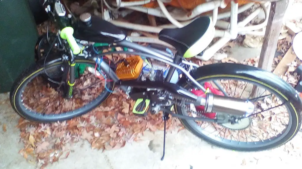

the gt80 kit showed up but the bolts to mount it to the jug were to long and the shorter one i picked up were to. the choke rod hits the frame so more work.
up to date pic

Cheap fenders have caused someserious accidents, broken bones, and ER trips to members on this forum. Just saying. There's a plastic set you can buy on ebay that don't mount right ON the wheel like that, they mount higher.
