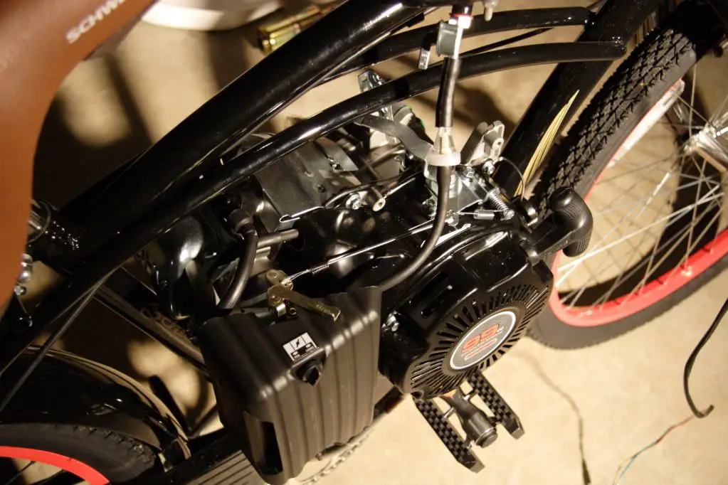

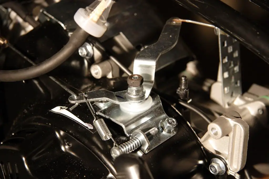

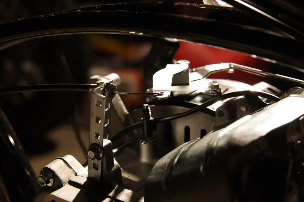

I just used parts from the engine itself... Here are some photos.

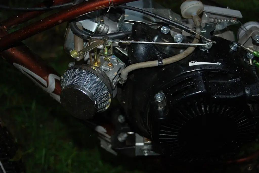

Here's my bone simple method 600 miles so far.
First I removed the fricton throttle lever.
Then I took the stock spring and hooked it towards the pto side of the engine, to pull the throttle shut.
Then I wire clamped the cable housing to the bike frame, close to the carb.
I then connected the cable end to the linkage with a slightly loose saftywire loop, in the hole next to the original throttle rod.
I did nothing internaly to the govenor and it causes no interference at all.
It's been a while since I did this but I think I remember rounding out a "D shaped hole on the bellcrank attachment hole with a dremel, to allow the linc to be independant of the govenor. Can't check mine until I get home this weekend.
