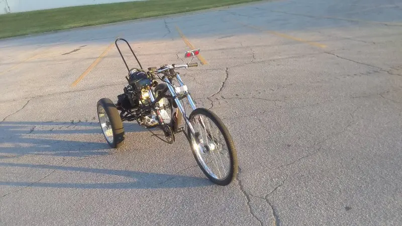

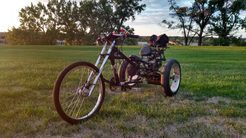

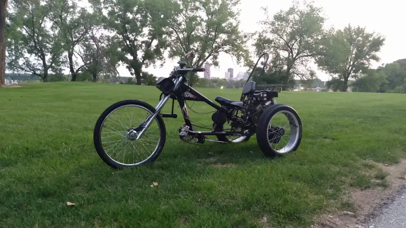

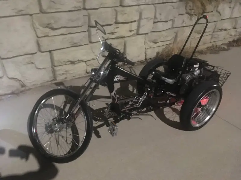

My Stingray Trike build w/79cc HF Predator motor

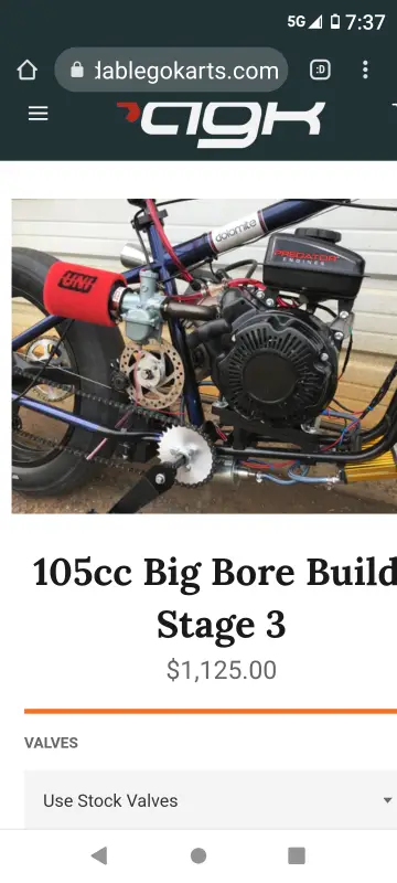

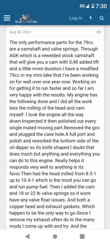

I recently got a parts bike with a billet flywheel for 79cc I found a head and this AGK company that sells performance parts... I don't have an engine yet still trying to figure out if the 99cc and 79cc are compatible... Then I'll send in a cam to get reworked...
