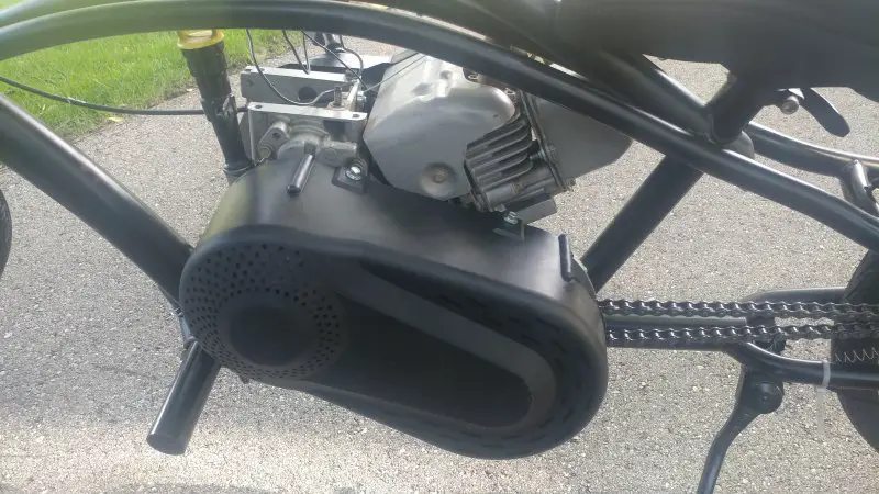

This build is very much a work in progress, but it is currently in a very much rideable state. I started with a Briggs & Stratton 120000 series, 206cc, 6hp, OHV, single cylinder, 4 stroke engine out of an old roto-tiller; I removed the governor (it won't hit high enough RPMs to cause damage, valve float and power will limit engine RPM), gas tank, hand throttle, replaced the spark plug, cleaned the carb (which still has a bad float, if I leave the petcock fully in the on position it overflows and floods), jury rigged a cable throttle linkage by using a spring from the hardware store and the lever which the hand throttle connected to on the carb (still need to get longer housing, not enough tension to bring it to WOT). The transmission is a Comet TAV2 CVT/torque converter, and even only being able to do half throttle it hits probably close to 30, don't have a speedometer yet to confirm. Wheels are from QBP (a bicycle parts wholesaler, buy from them through my work) and are DT-swiss spokes on DT-swiss 466d 26" rims on Shimano Deore hubs (I used two front wheels and swapped to bolt on axles for both, I don't trust a QR skewer for this). Front brake is some kind of hydraulic brake from what looks like a dirt bike, bought it from Lynn at www.mbrebel.com (you should check her out, really nice lady with good parts and good prices; I also purchased my fork, mounting plate, sprocket, sprocket adapter, throttle and grips from her). Tires are Continental Touring Plus 26x1.75 (I plan to swap to Conti Top Contact II 26x2 tires when these ones wear out). Rear brake is either going to be a Hayes MX5 on a 203mm rotor, a Sturmey Archer XL-FD 90mm drum brake, or a Worksman drum brake: not quite sure yet. Kill switch is just a toggle switch hooked up to a grounding wire from the magneto/coil, and kills the engine real fast. If y'all have any questions, let me know, I'll update this thread as I keep adding on to this bad boy.

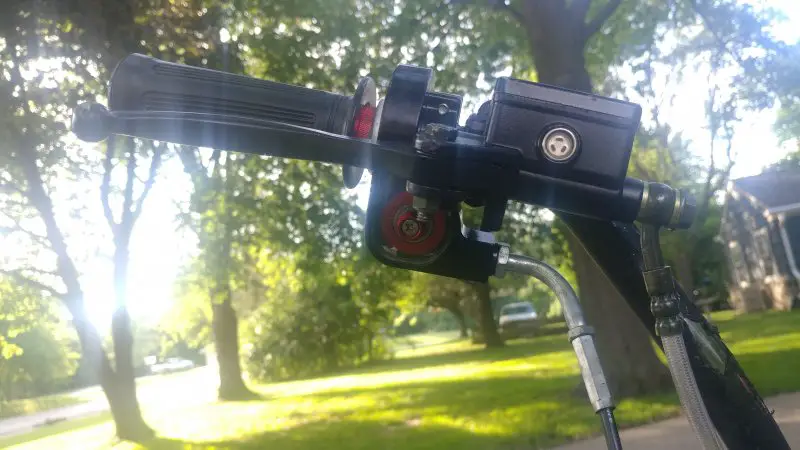

On a general note, I did end up swapping out for a Predator 212, which took all of an hour, and changed out my twist grip for a long pull brake lever (return spring too strong, I'll use the throttle grip again once I get a mikuni on this bad boy). I got rid of the stock muffler and welded up a simple straight pipe using part of the original muffler and some exhaust pipe from the auto store then wrapping the ever living **** out of it with (in order): repair tape to protect the welds, heat wrap, fiberglass insulation, and then a double wrap of heat wrap all to keep my leg unburnt. Exhaust is actually pretty quiet, especially compared to many other bikes in the area (Harley country), and the only issue is the occasional loud bang from an afterfire. I used left over wrap and some foil HVAC tape (probably will swap to EB green for looks and strength) on the "front" of the transmission cover and recoil cover to keep my calves cool, and it seems to work well. Was able to adjust the angle of the front brake caliper a little to get the pads to bite the rotor better, and for the rear brake I'm going to lace up a moped drum hub from Lynn at http://www.mbrebel.com into my current rims with 10g spokes from J&B; hub comes with a 54t sprocket which I am not even going to bother with (front wheel needs to stay grounded), I'm going to pick up a 36, 38, or 40 tooth sprocket for it from a site I found that has the right sprocket with the right bolt pattern. However, I'm sticking to an MX5 rear disc for now, getting lights is more of a priority for me than a drum brake.
As far as speed goes, this thing does move, and it moves fast. I haven't been able to get it on a stretch of road to take it wide open, but cruising at anywhere from 25-40 is effortless (motor isn't screaming like my China girl electric start bike at 40) and pretty smooth (idle is fairly vibey, but not so much at speed).
