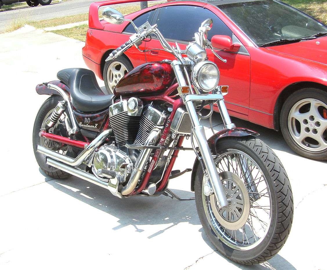

128 mph, 5 speed manual, 1400cc stock engine, no peddles Wheel base of 60+ inches helps too. Everything they said ^^^ Suspension, brakes, and beefy frame...
I have front and rear suspension. And good stopping power. The difference between 44 and 125 is huge. 1.5 hp versus 94hp.
Ok... let's get back to bicycles... We can show off our other rides in our own postings...
Yeah funny, but the difference is that Im using the same **** china parts that many other bike builders use. It comes close to reaching the desired speed he wants without buying a four stroke boat anchor without having to peddle. I just picked up a wide 5 speed manual tranny for it too. Yeah im ****ing proud of my ride. The question to build the 55 mph cruiser requires one to think outside of the 199$ bike kit. its what I do. Besides.. WTF difference does it make if you break the law on a 55mph moped or a 44 mph foot scooter? nada. Id love to hit 55 on my ride. its silky as is.
It's OK to be proud of your ride, even if it hardly pertains to how one would build a 55mph cruiser engine... but there is a difference between actually helping someone out and inserting yourself into everyone else's post just to show off your ride....
Why not tell everyone what engine that is and how you got 4hp out of it? Why not tell everyone about the 3 speed hub being used as a transmission and how you set it up? ... that would be helping... posting a pic of your ride and saying how fast it is hardly constitutes what most people would call help.
