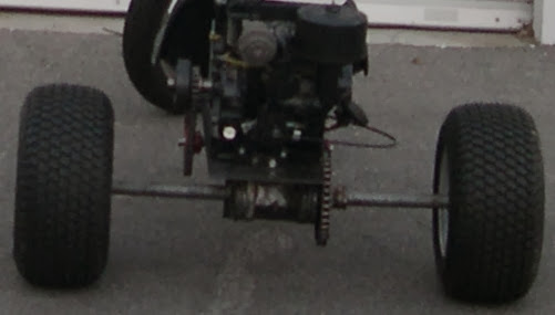

5 hp briggs tricycle, brainstorm ideas
jared8783
May 13, 2009
216
Elkhart, IN
Ok so I bought this like axle with bearing mounts (one bearing bad woop dee doo). Anyways 10" diameter tires with a sprocket attatched. Way I see things I'm a 20" donor bicycle away from being able to make this. Using the headset and forks off the bicycle. I already have the engine sitting around. What would you do with this if you had it?
Intrepid Wheelwoman
Oct 29, 2011
2,830
62
Hauraki District, New Zealand
What is that axle from? It certainly is pretty darn chunky looking. What is the track measurement? - The lack of a diff could be a problem for road use, but otherwise using it as the basis for a Briggs powered trike would certainly make for a fun build.
FFV8
Oct 29, 2013
551
16
Spring Valley NV
Jared:
I run a solid axle from a Polaris quad in the back end of my trike
It corners better than I thought it would. Of course I have a fairly low CG.
