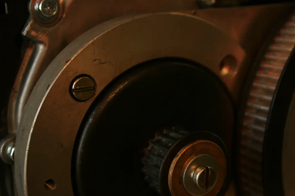

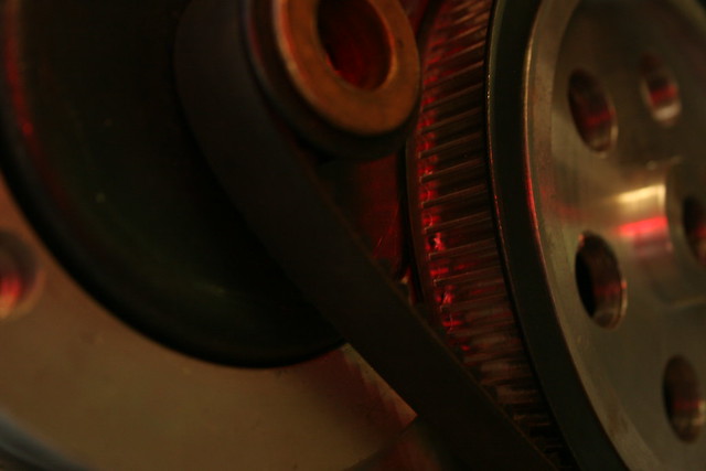

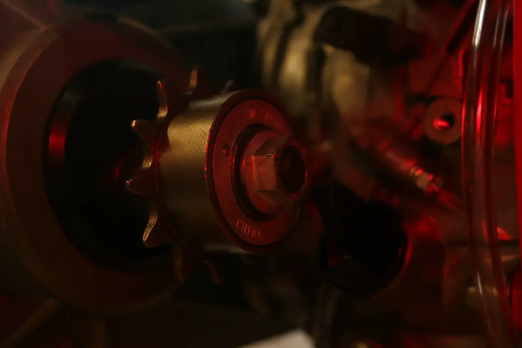

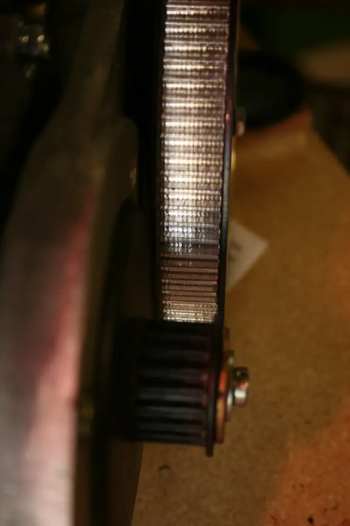

In looking at your pictures, your freewheel sprocket appears to be mounted in the reverse of the way mine is mounted. You might want to check that. Reversing that sprocket would give you the offset you appear to need, but then would the freewheel operate properly? Just a thought.
Check out this thread: http://motorbicycling.com/f23/4g-t-belt-drive-installation-problems-17492-9.html. Post 88, pg. 9. Install the clutch the second way shown (with the small washer). Also, make sure that your large pulley isn't on backwards. They have different offsets on each side. You could also put a washer behind your large pulley to get it to pull away from your clutch bell slightly. Keep in mind will affect your pulley alignment. You may have to use something thinner to shim it out for the proper clearance. Pay special attention to the last picture. Install the clutch hardware in that order.
This was the problem... I had just installed the big pulley how it came shipped to me without knowing that there were different offsets on each side. Now it clears.
