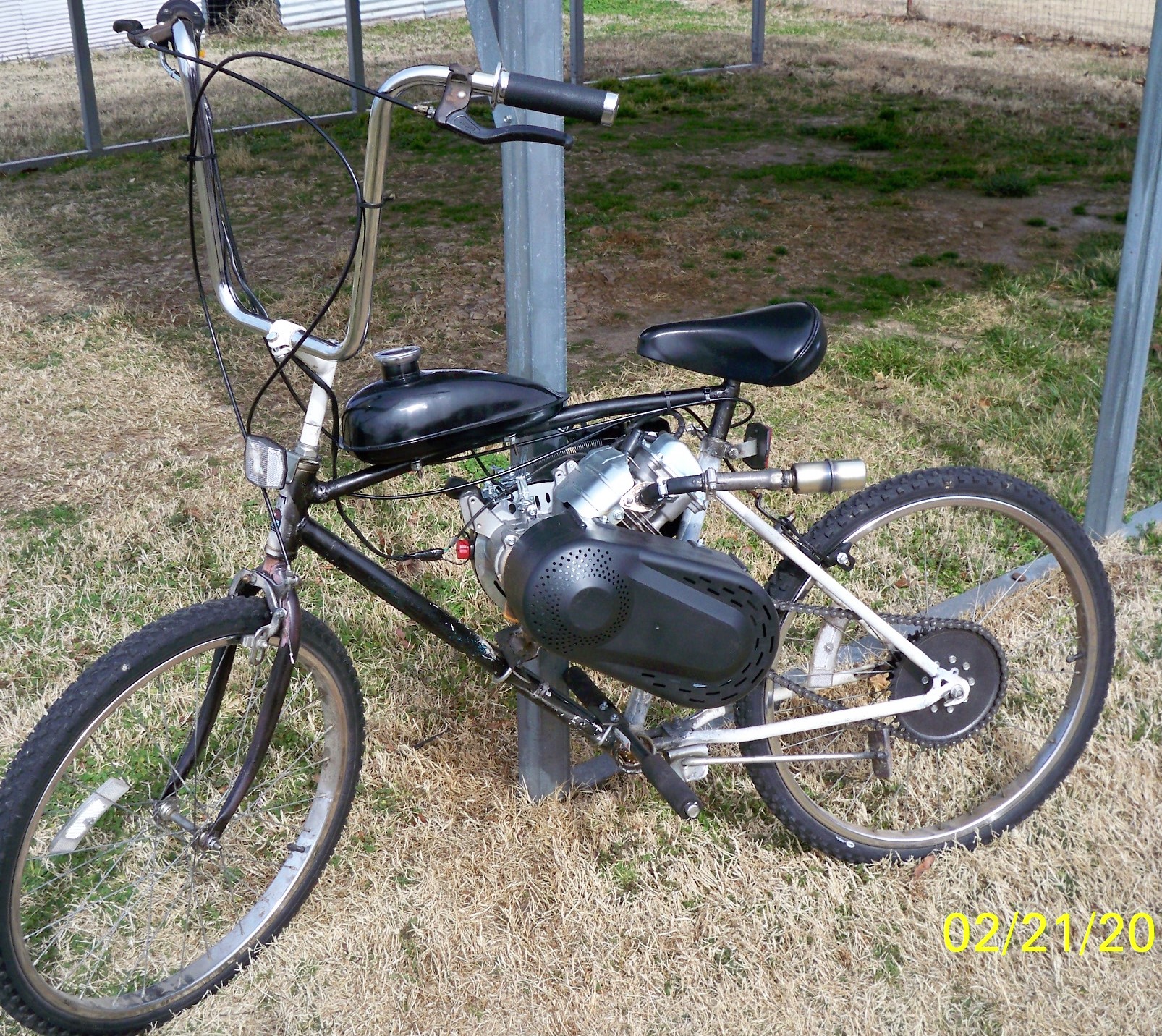

I have two of the two strokers and I'm wondering why you had so much trouble ,I've had 3 all together and they have all been really good,here is a pic of my favorite of the two,the other one is really good one too but may be sold. Since the pic was taken I have added caliper brakes.

Just wondering out loud Norm. James, that's the frame you wanna use if you keep it. Not sure what guys spend on frames but you can buy a Whizzer frame for $230 I believe. And you aren't hurting those.
I bought this bike and two roadmasters from a local pawn shop that was just dumping bikes at five bucks each. Tires on the one I used are nearly new ,no cracks,it needed crank bearings .I took the two roadmasters and made one very good 18 speed mountain bike.I just bought a Huffy Regatto hardly ridden for what I had in my pocked 39 dollars.So far the little frame has not given me any problems,welds are holding up,if it ever did I could just get the welder out and reinforce it. Thanks for your comment.
