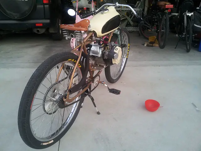

beltbuckle

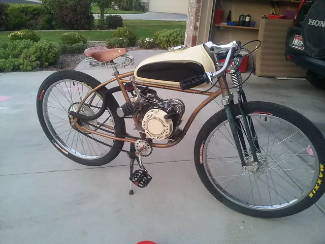

Keep checking off tasks on my second build.

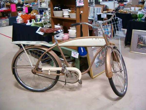

bike started off as a 1955 AMF Roadmaster, frame was in good shape, wheels had seen better days.

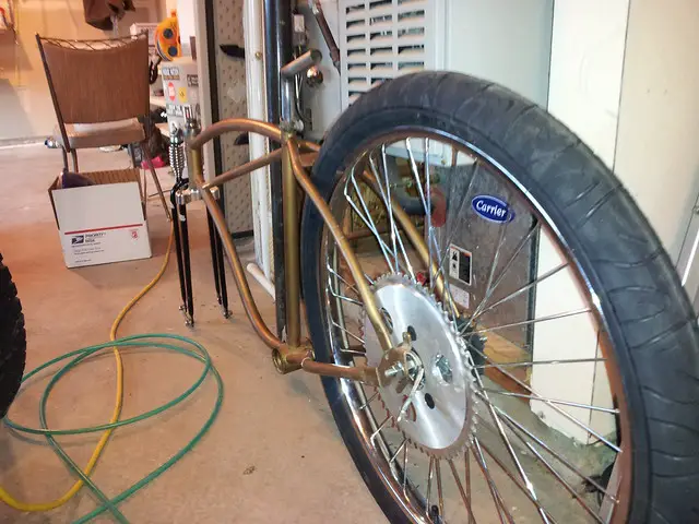

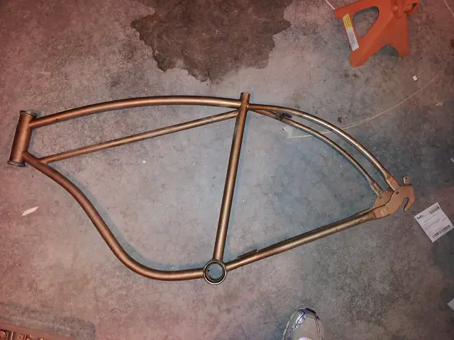

Got her stripped down to the bare frame

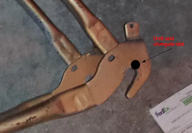

Ordered 2 x 26" husky wheels with 11g spokes, and sturmey archer drum hub on the front. Put Maxxis Hookworm tires on the new wheels only to find the back tire wouldn't clear the chainstays. Elongated the rear dropouts a bit to fix that.

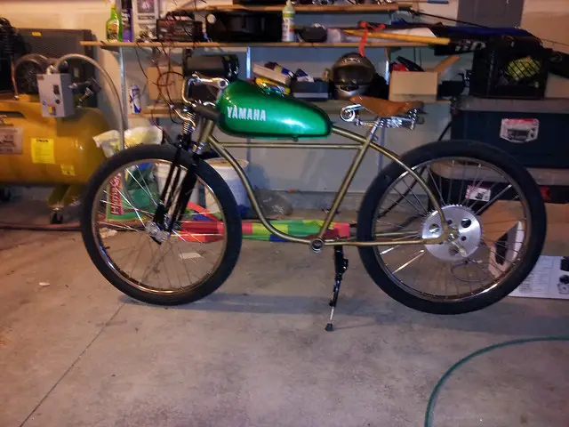

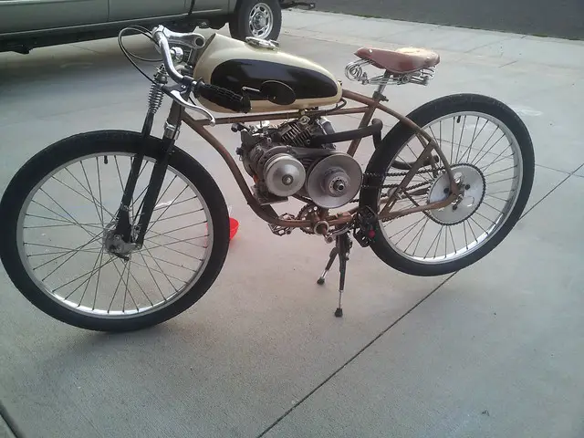

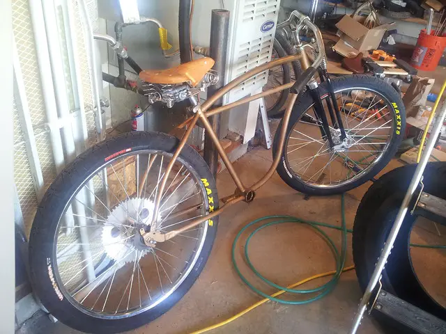

Hookworms on! Installed sportscarpat's rear sprocket adapter, layback seat post, and new saddle

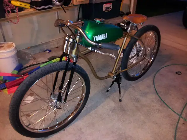

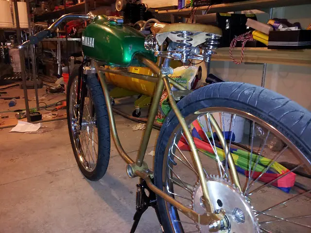

Got a Monark II springer for the front, starting to look like a bike again.
