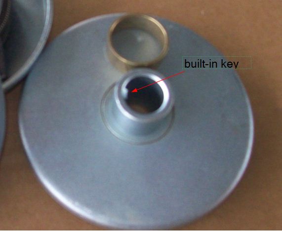

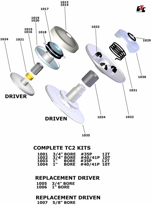

The problem is that the torque converter driver (piece 1024 below) has a built-in standard depth key. This is not deep enough to go past the sleeve into the actual keyway of the shaft.
built-in key
tav2_driver
I know several people have mated the driver to a 5/8" shaft - looking for help on what others did to get this to work.

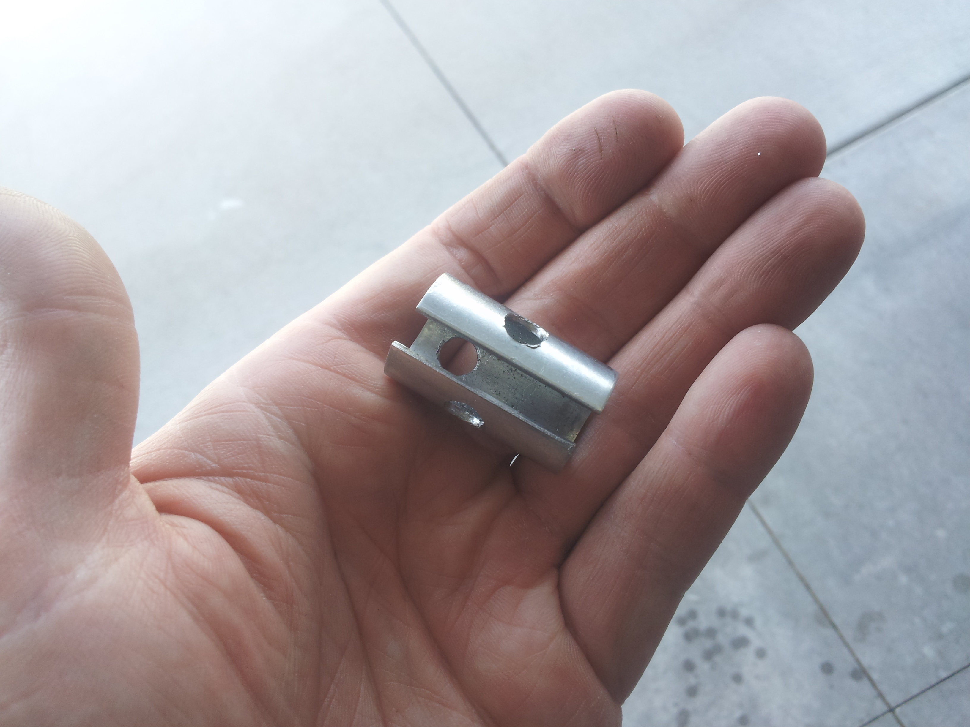

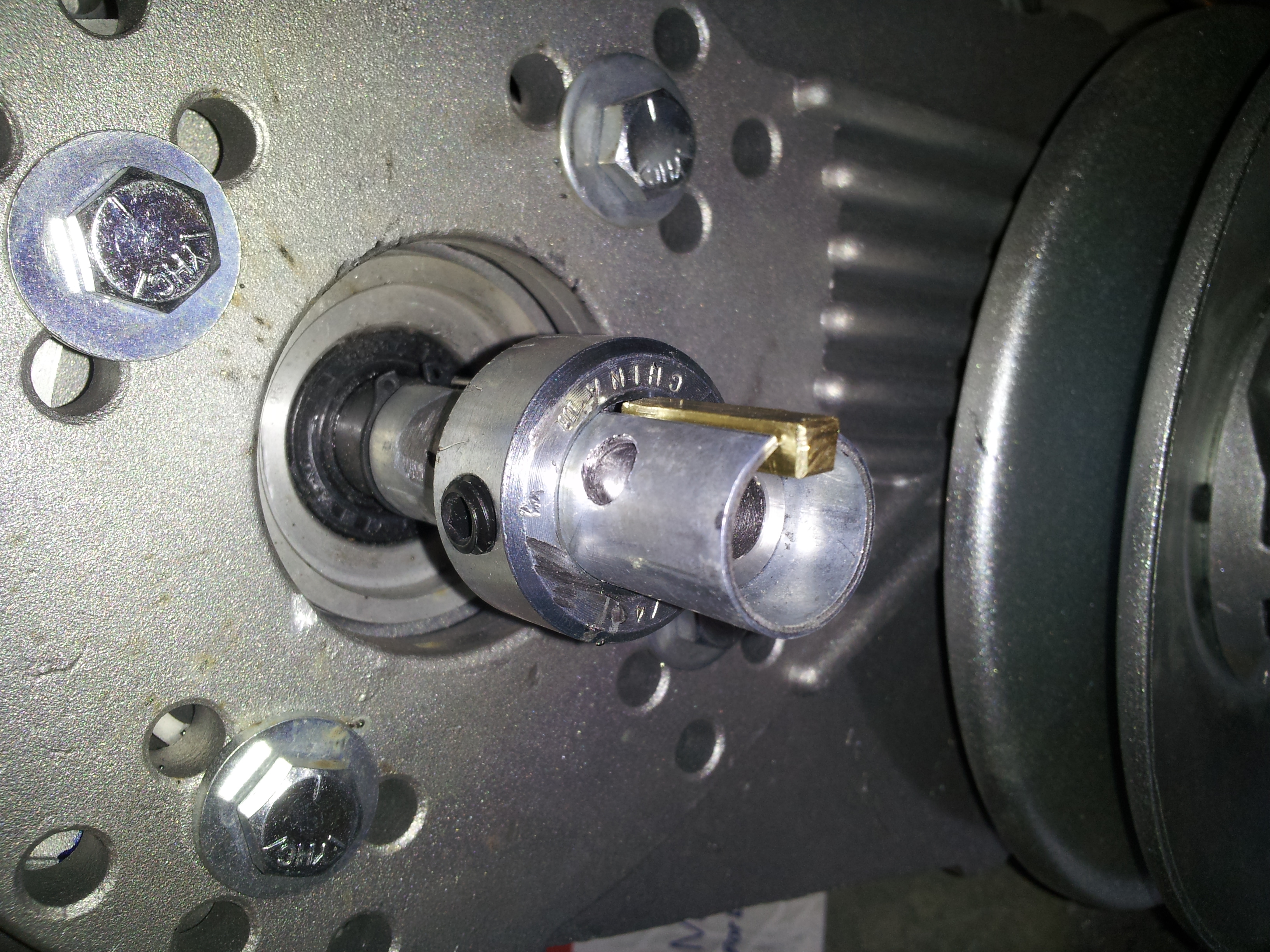

i used a total of two of these bushings, and drilled and deburred three 1/4" holes in each bushing
i put a collar part way on them and the key in during welding to keep them compressed tight and aligned to the shaft.

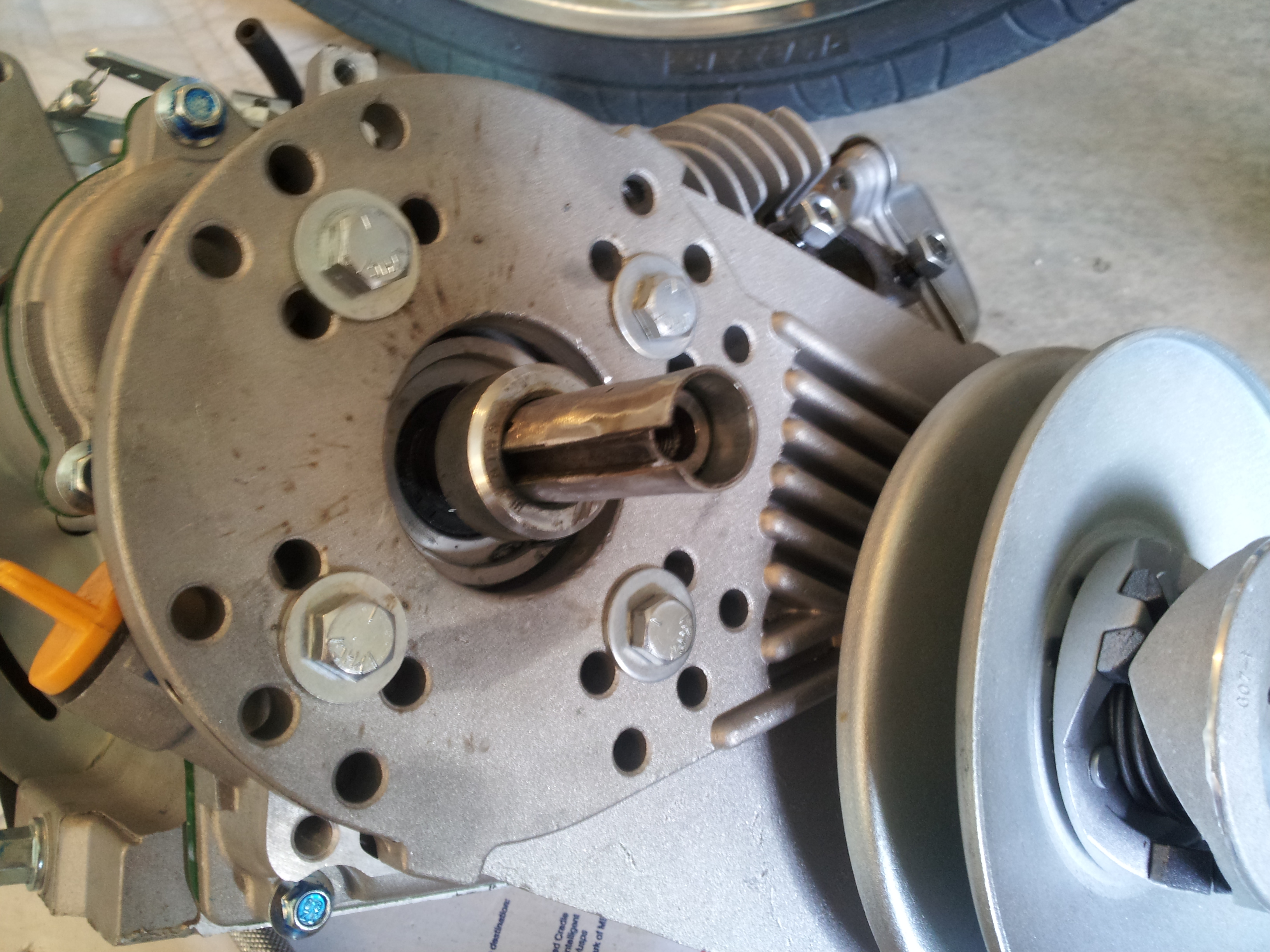

after welding, ground the welds down smooth and finished with a paddle disc on a hand grinder. the collar will keep the engine-side piece of the driver from floating.

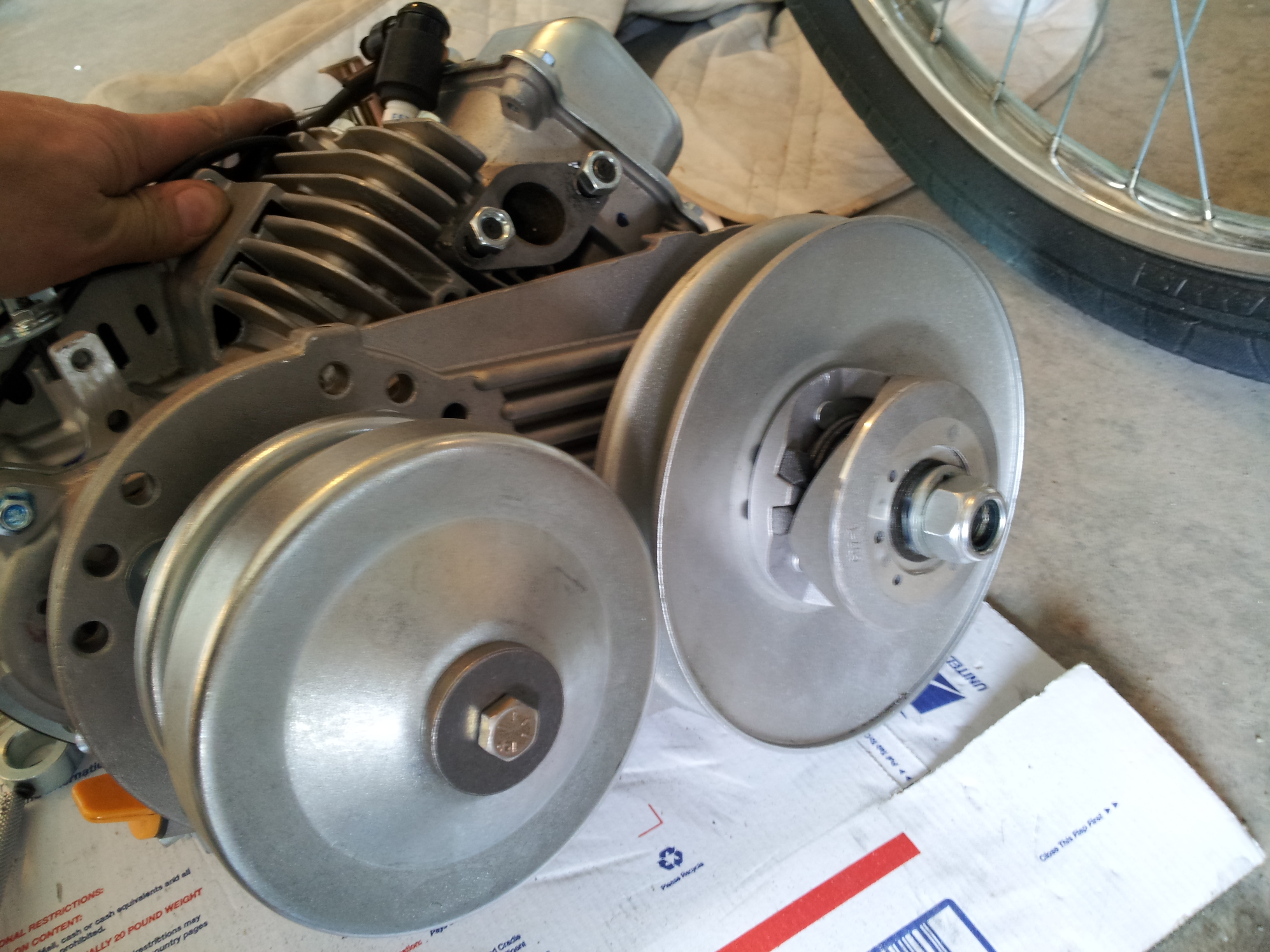

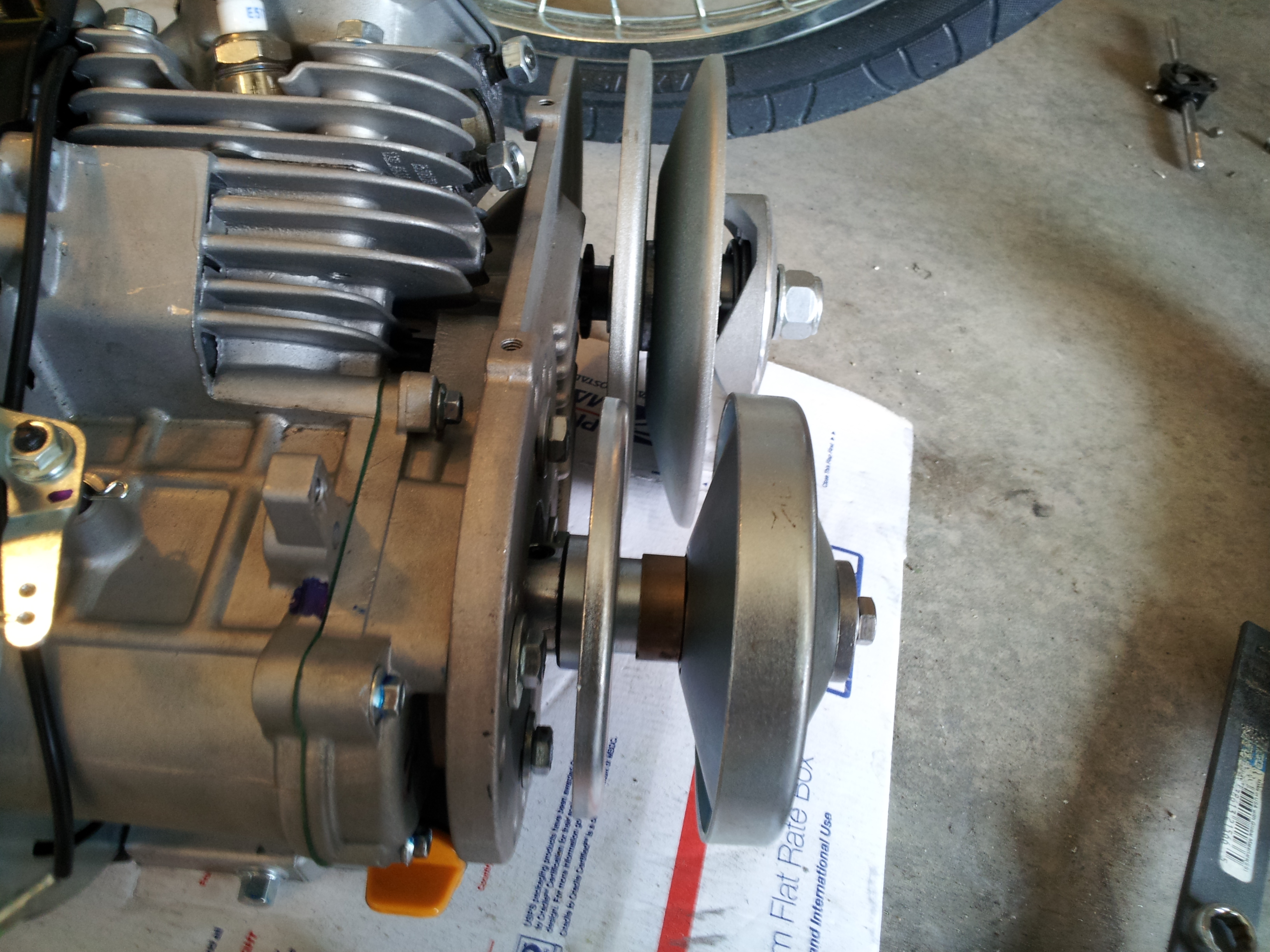

CVT test fit.. it fits.
i think 6 rosette welds should be strong enough to keep it from spinning on the shaft, time will tell. they welds are quick and i don't think the heat on the shaft is too much of a problem. it probably did soften the heat-treated shaft a bit around the welds but my gut feeling is that at the 3HP range this is strong enough.
on to the next problem.

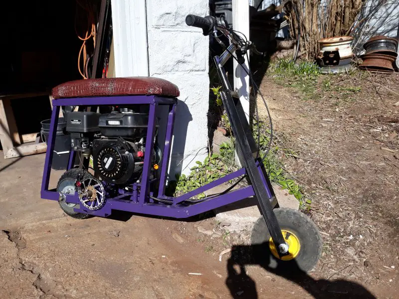

I had the exact same issue. I ended up using a Ironton 208cc (with 3/4 shaft) instead of the 79cc Predator I wanted for a minibike. I'm happy with the power, but wanted to keep it small.
I pretty much settled on the 'shaped spacer' idea, like most of y'all...Using 3/4 conduit with the keyway cut in.
I figured the motor only turns CCW, so one fixed key in the clutch would HAVE to be spun by the key in the motor shaft....IF the play in the bushing / adapter wasn't too sloppy.
Good luck.
Here's the first one with the big 6hp on it. And the plan I found online...a 1951 Popular Science reprint. If you do this, make your frame an inch wider, and about 3 inches longer in the rear. Also, I used cheap 5/8 pillow block bearings instead of the odd parts on the jackshaft. AND...as tight as their frame dimensions were, I added a cheap bicycle disc brake to the jackshaft instead of the go-kart band brake. Easier and more elegant.
