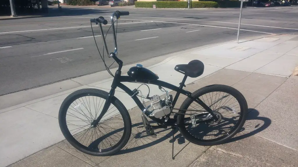

Hello. I'm about to create one of these monsters. I need to know what sprocket adapter size? Everything is on order, so I don't have the bike to measure the rear hub size. Thanks in advance.

Got it done.
The 1.5" hub adapter is the size needed. They sent my a 40T by mistake, it's fast!
Here's the rolling beast, I'm breaking her in now.

It's not a bad ride at all. The pedal geometry feels a little strange, but that could just be me. The bars are not exactly what I wanted, but work. These feel a little narrow, they might be more for an old 3 speed schwinn. The only real downside to the bike is stopping power. The really big 29" wheels don't want to stop spinning, fast!
