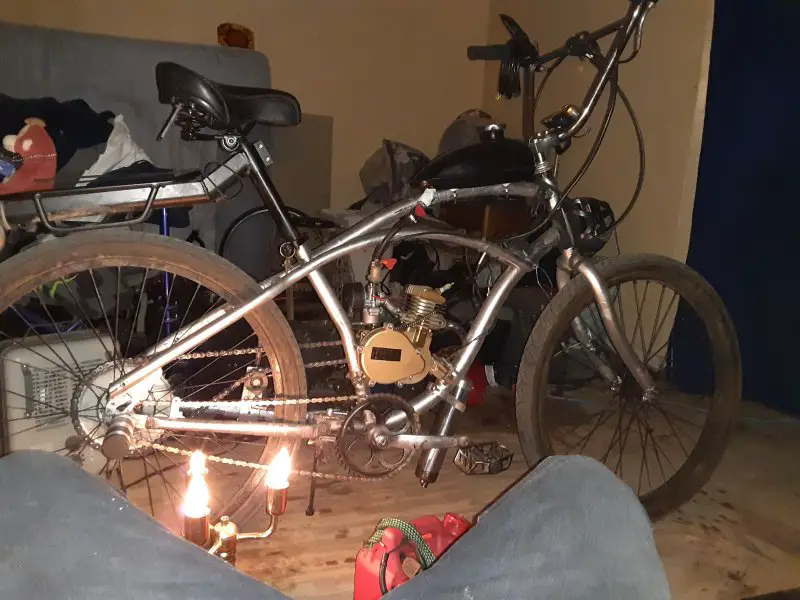

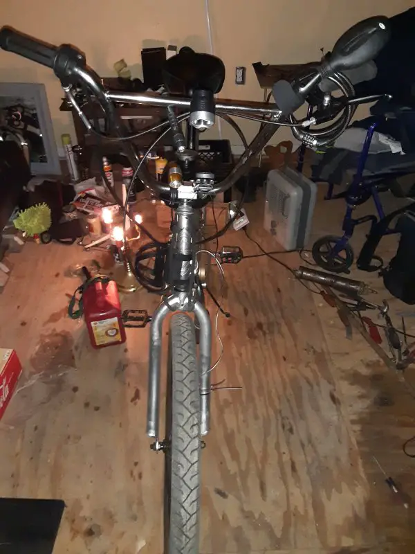

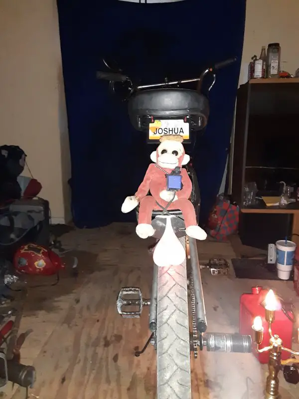

J Joshua Gill New Member Jan 13, 2020 #1 Any comments or advice? Attachments 15789257510301252631813277573021.jpg 94.7 KB · Views: 391 15789257856757262825716213353804.jpg 72.1 KB · Views: 415 15789258398184947142537729828284.jpg 91.9 KB · Views: 347
xseler Well-Known Member Jan 13, 2020 #2 Might wanna think about adding some front brakes...….at some point, you'll be glad you did!

Greg58 Well-Known Member Jan 14, 2020 #4 You can add bmx style side pull brakes, I see the mounting holes in the forks. 96mm reach worked on mine, with good pads they stop well. I got mine with cable and handle from eBay for around $20.
