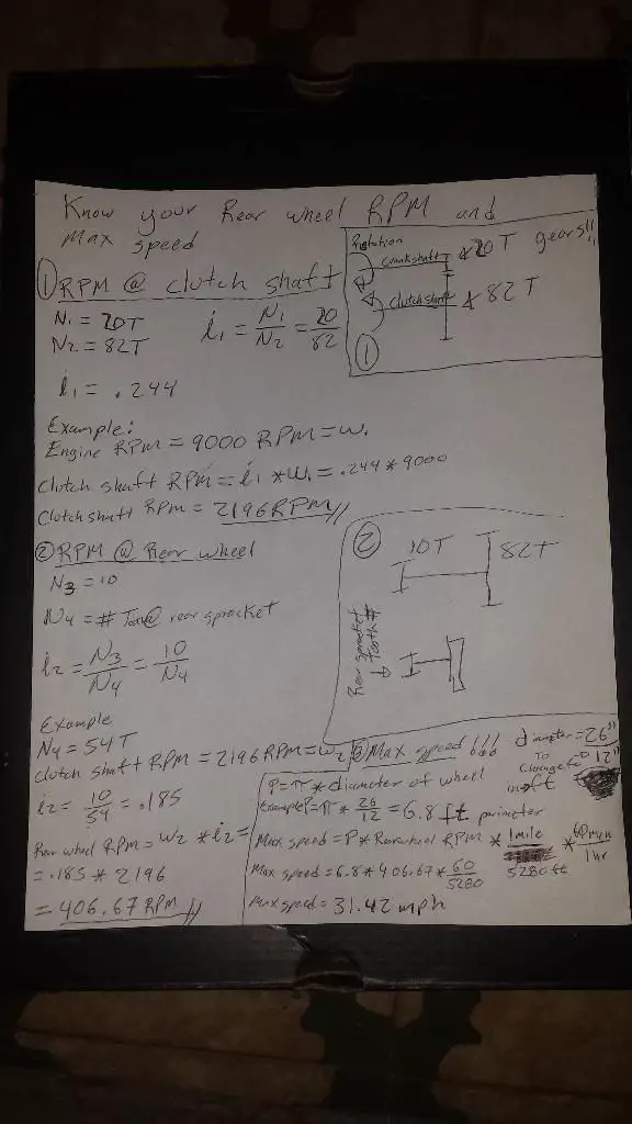

Know your clutch shaft RPM, rear wheel RPM and max speed!!!
mech_engineer
The knowledge is the road to the success!!!
I hope this will make faster bicycles... this is a approximation because of the chain.

to obtain the wheel rpm you need to do the step 1 and 2 of the paper... sorry for the writing quality. but i dont have time to do something nice because i work all day and study at night.

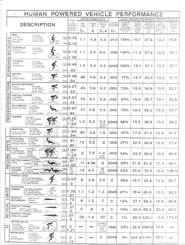

All the charts & calculations above aren't for establishing speed, rather they're for optimizing gearing for a speed.
There is a lot more to calculating a "max speed" then RPM, which in fact has little to do with any actual achieved speeds. Gearing will allow you just about any RPM you'd like - but that doesn't mean that RPM will be even remotely effective.
Here's one of many "speed & power" calculators that tries to encompass the real world variables, of which there are many;
http://www.kreuzotter.de/english/espeed.htm
...and let's not forget this devilish detail;
