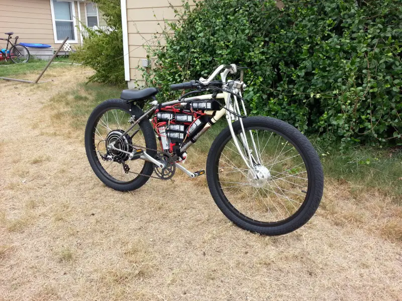

I LOVE riding this bike! I was afraid that with the cheaper, fast wind motor that I would not have enough low end torque. But it carries me well at 200 lbs. I just got her running yesterday so only put about 5 miles on her, which included an errand up to Walgreens, but I could not be happier with this as my first hub build.
The neighborhood speed limit is 25 MPH, and the road to downtown is 35 MPH, which she does comfortably. For giggles on the shakedown run I had to see what she had to give, I backed off at 47 MPH when I ran out of straight road! While I know spending much time in that range will kill the motor, I had to do it, just had to ;)
Next up is to clean up the wiring, install lights on the front and back, make some sort of protective covering for the batteries, and possibly fans to help cool the controller. I noticed it got really warm even on my short run, but it was close to 100 degrees outside at the time.
So overall, this build cost me around $1,100, which was almost exactly what my gas bike build cost!

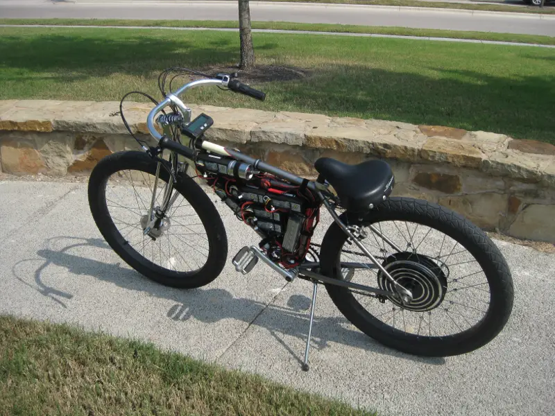

I was not crazy about the look of the layback seat post raised up, so I slammed it as low as it would go and have a little clearance over the rear tire. That made the taller bars look goofy so I flipped them. I plan on getting some no-rise bars soon (likely the Nitto Promenade B617), but it will do for now. The riding position is surprisingly comfortable.

Installed my new Nitto B617 bars last week. More of an upright riding position, which I have grown to like a lot over the last week.

And I had to know... I just had to...
I reprogrammed my controller to run 45 amps (it spiked to 52A at one point in my run), put on my motorcycle gear, and went for a high speed run. I backed off at 52 MPH... I just wanted to see 50 and not turn my motor into molten lava.
That is the first and last time I try that with this setup, but I had to see. I took my phone with the GPS turned on to verify the CycleAnalyst's speedo reading.
