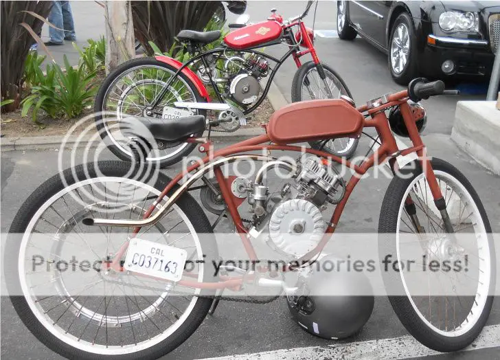

Those Bikes look amazing! The vintage frames look phenomenal!!
How big is the motor 250cc?
Thanks 66cc. The motors are the 13 series, which is 13 cubic inches. Here's one with an 8hp Briggs I made a about 15 years ago.

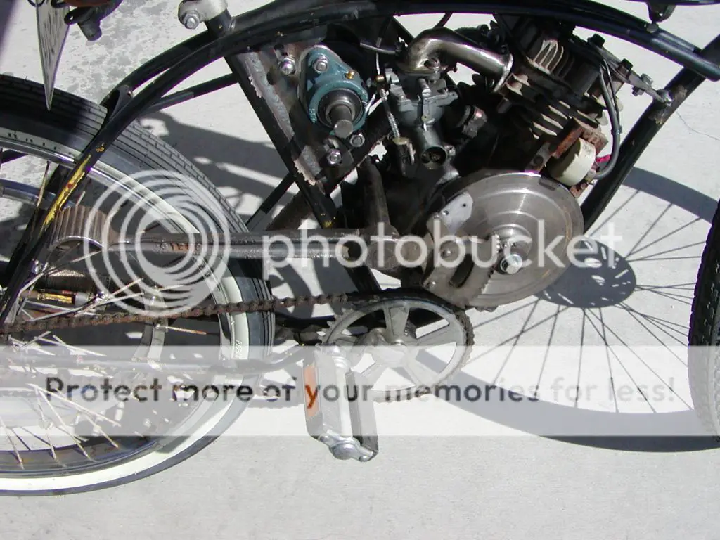

You on the right track now with 8.8:1 ratio. I retained the pedals by tilting the motor forward, adding a compression release, belt drive and using a clutch with a one-way bearing. That allows for real easy pedal starts.

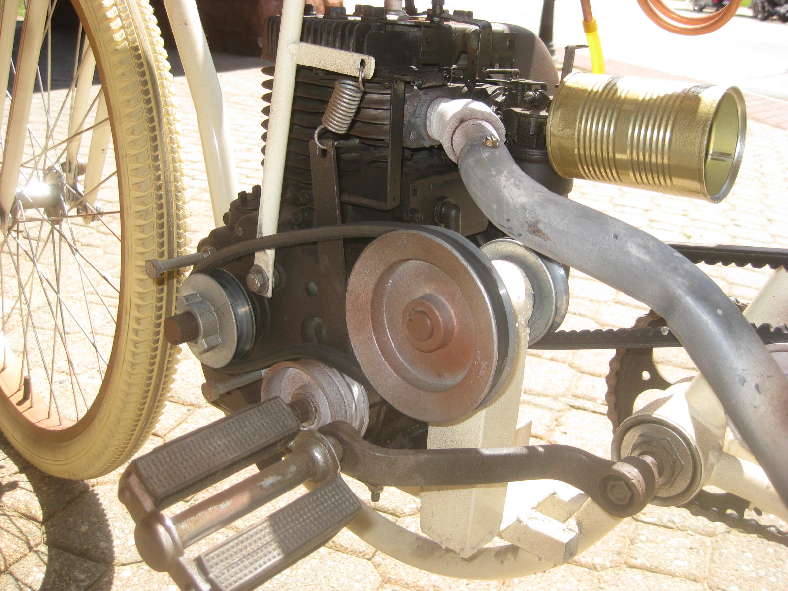

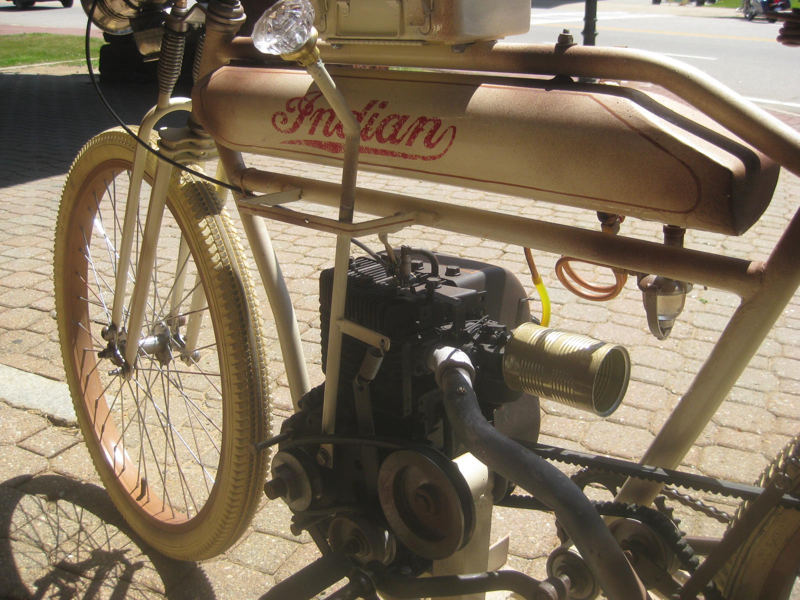

I've built a couple of these and found a belt drive not only looks cool but works amazingly! You just need to have a rear wheel sheave or pulley from a whizzer for the right gearing. After running 5hp Tecumsehs and Briggs, you'll never go back!
AMEN! I had a factory made monark when i was a kid, and got hooked on belt drive, doing one now with a small Lauson motor.
Nice builds you have, like them ..............Curt
