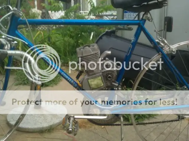

Yesterday when I test fit the motor. Yes, the drop bars are still hanging by the brake cables, there are mountain bike flat bars on it now:

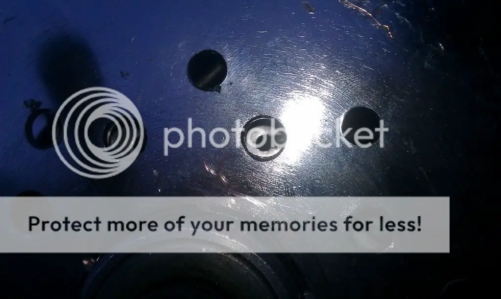

The offending flange:

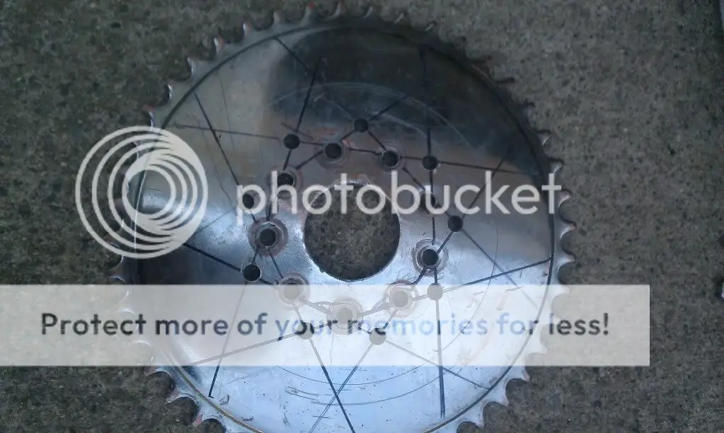

What you see looking thru the existing holes in the sprocket:
Sprocket after drilling:
When looking at the sprocket, I realized that the edge of the flange was almost perfectly even with the outside edge of the existing holes. Basic geometry told me that if I took a straight edge lined up with 2 bolt holes next to eachother and drew a straight line, the repeated all the way around, 2 lines would cross 1/2 way between and a fair bit out from the original holes. I drilled where the lines crossed, and viola, 9 new holes exactly where they needed to be.

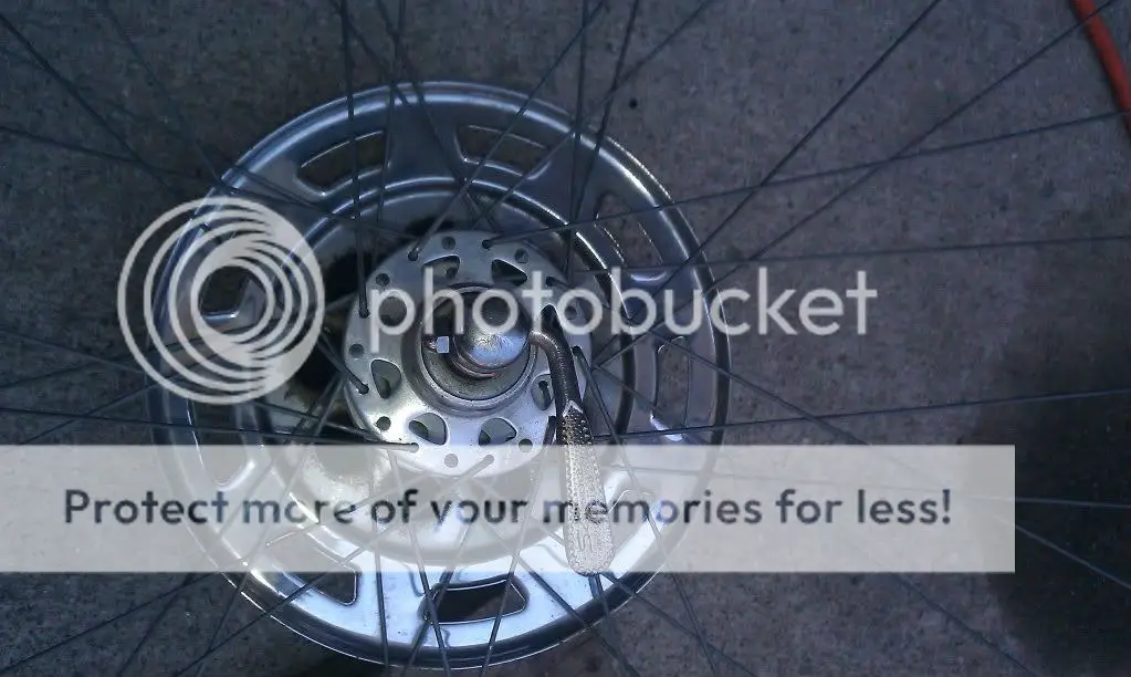

Hello Steve,if Your getting a new sprocket,and if the center hole fits tight to the hub like the old one shown in post six,You can drill holes to match the little holes in the flange and bolt it there...That way Your driving the hub and not just the spokes on the left side...Just an idea...Tigmaster....

You can also grind a ridge on your schwinn hub to clear the center hole, with a flat file, by simply putting the wheel in the frame and turning it upside down- and pedaling by hand- the wheel becomes it's own grainding wheel -the hub will tolerate enought alloy off that side- same as the other side of it- hold the file about 1/4 inchj from the hub edge until you have a nice ridge- (See attached thumbnail)
