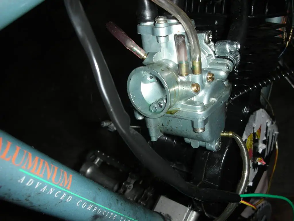

my new style CNS carb and stock filter.

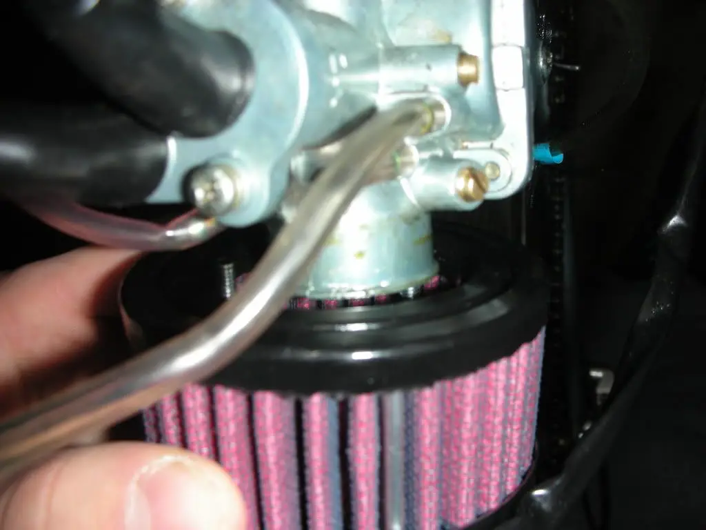

my new style CNS carb with SBP HD air filter

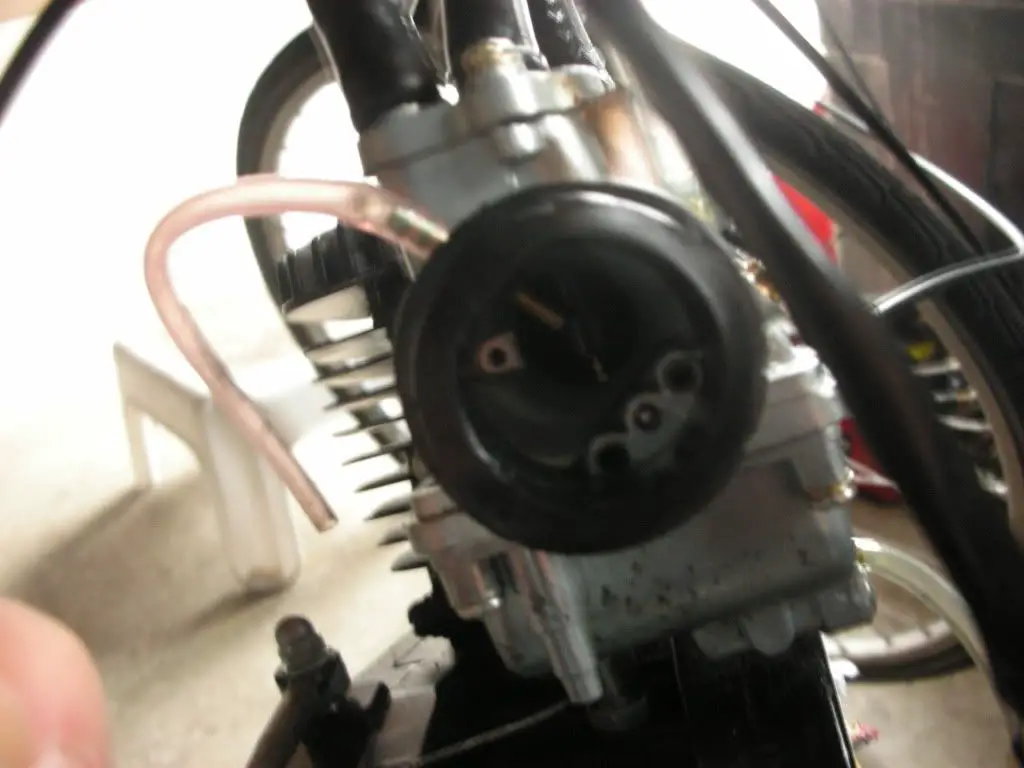

and the the new style CNS with NT stock filter
the sizing for the NT and the new style CNS are the same..

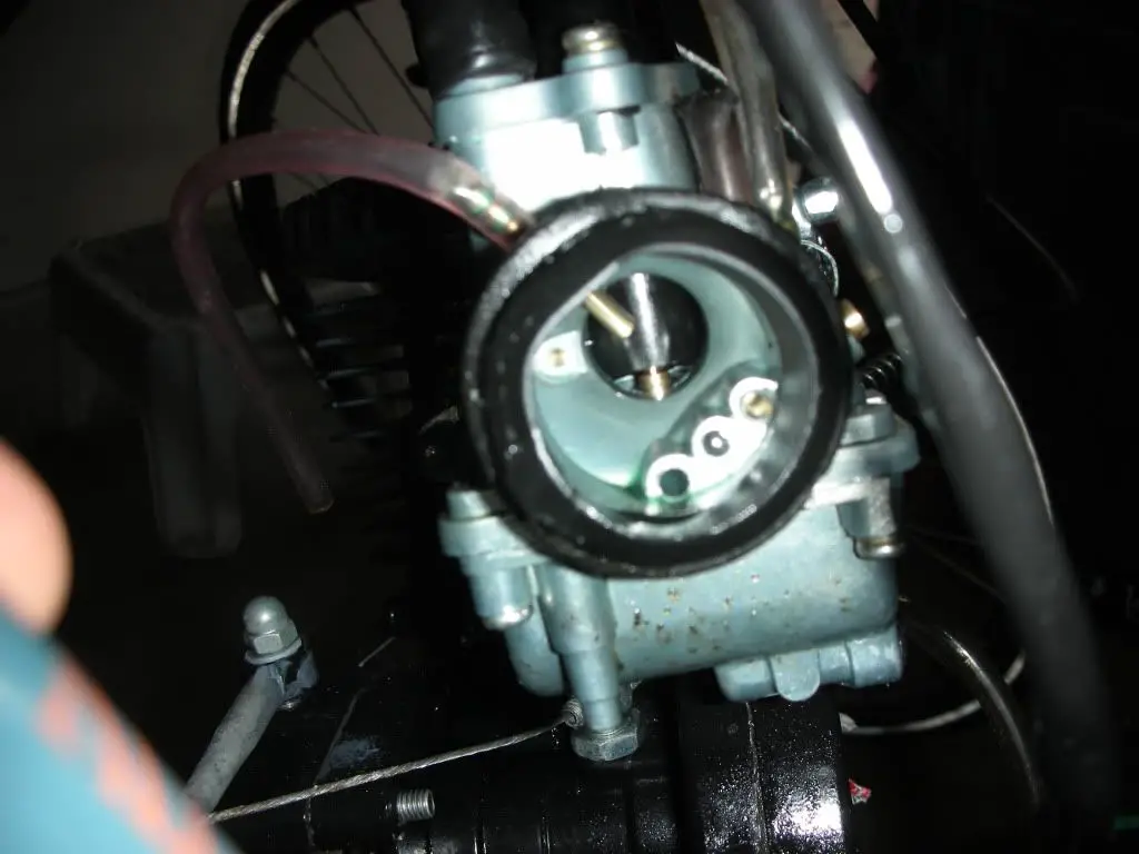

NT air intake.
new style CNS air intake
and the old style CNS have a clamp on filter. so unless it came with a clamp and not two bolts. it should fit id think? are the carbs for 49cc and 66cc the same??

you will need to remove this i think? i did and it fits right on there. and there is no need for it once you switch to the SBP filter. all it dose is stops the air filter pad in the old filter from being sucked into your carb.

sorry to tell you, but you have the CNS #1 as i call it. this filter is not made for this carb. you can get other clamp down air filters for your carb. but as far as i know, you wont be able to use that filter with your CNS v1 carb:(
there may be an adapter or something for this problem? but you have a bolt on filter and a carb built for the clap on ones with the rubber boot.
any other carb CNSv2 or the NT model will fit the SBP are filter.. sorry about your luck.:(

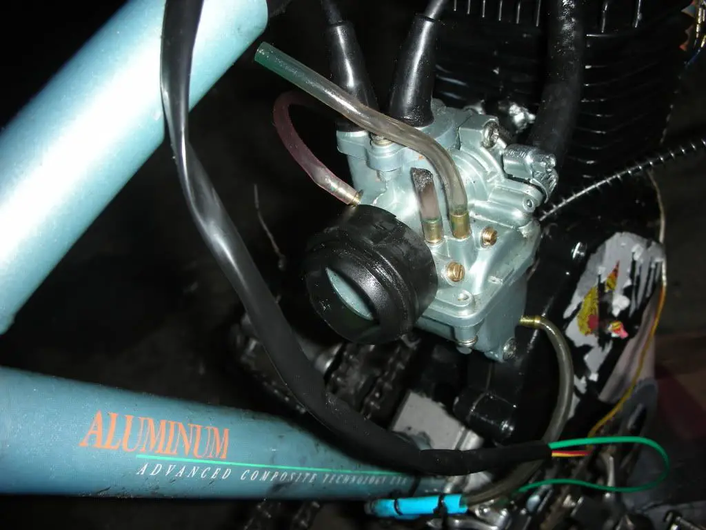

...i don't even know how this is working. The "vent" tube on the top is the fuel enrichenment port for adding fuel when you choke the motor with a CNS carb. The tube supplying fuel is at the bottom of the carb bowl. These two "vent tubes" are barbed so the hose won't come off. The two vent tubes that are side by side are vent tubes. It is a good idea to run tubes from them simply leading down so that dirt can't fall down them. These are called "down draft" tubes. They work just like the draft tubes used to work on cars before emission laws.
The CNS carb is almost identical to a Bing carb from the late '60s to early '70s that was on a Bultaco Combat Wombat I used to work on.
