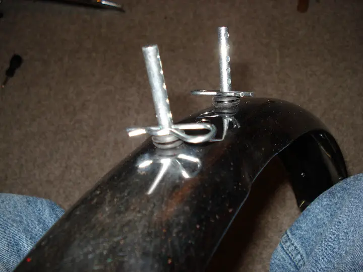

Huffy fender fail PHOTO
yodar
fracture not visible FROM UNDERNEATH because it is hidden beneath u-bracket
Nothing new, Yodar.
There have been numerous reports of fender bracket failures. We recommend that if you run fenders to reinforce the fender and brackets. Search 'fender failure' and see what others have experienced and done to fix the problem. Bairdco did a nice tutorial on fenders. You can also PM Dan and let him give you a first hand report of what can happen if the front fender comes loose and wraps around the wheel. :(
Nothing new, Yodar.
I KNOW DAT! I thought a pitcher would help the nonbelievers
You'll see my most recent pitcher of the bike with newly installed spring-fork, LACKS the fender`!

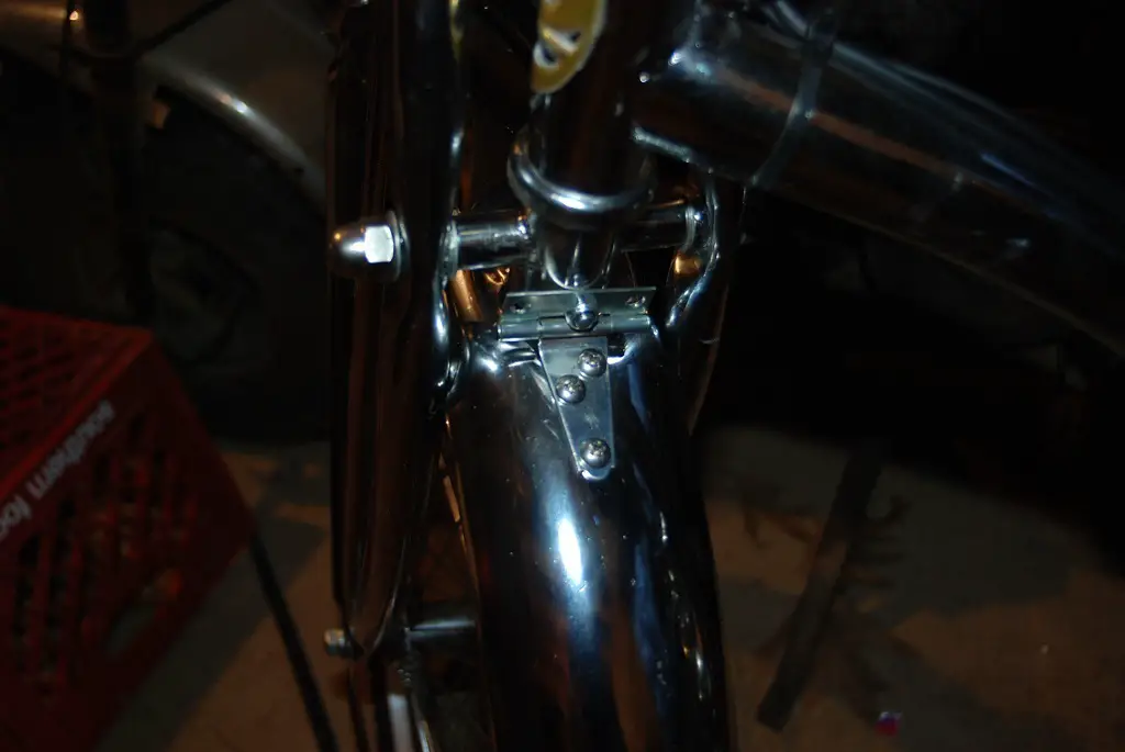

Here's my fix for a fender on a springer. Should work on non springer too.
Gonna trim the corners or bolt some ornaments there.
Here is my solution...
before I cut them to size.
Now they are just long enough to hit the frame if things go bad.
We can do what Wayne did using the L brackets I have or we can just make some out of the flat steel I just bought
Sorry Joa ,look closer, That's NOT an L bracket.
That's a T HINGE>
To use ANY L-bracket on a springer fork is guaranteed FAIL.
The fender moves with the springer travel, and the fork centertube bolt dont move at all.
I wanted the fenders to stay,so I am experimenting with a T hinge there.
I decided to trust the rear fender tab, and it let go after 3 miles, letting the fender get sorta intimate with the chain down there. One good ziptie to the other side of tab mount got me home.
Now another good ziptie on the other side keeps it centered :~)
Zipties would be a good backup safty for our fenders.
There's probably a guaranteed fail in my method shown above. Just came to me
The fender hinge axis is so far away from the springer hinge, that something is going to crack from being stressed eventualy, prolly fenderstays.
Hinge would work great for non moving fenders though..
Ideal scenario would be a custom bracket hinged on the same axis as the springer.
Or maybe a rubber/kevlar hinge like maybe a piece of automotive serpentine belt?
