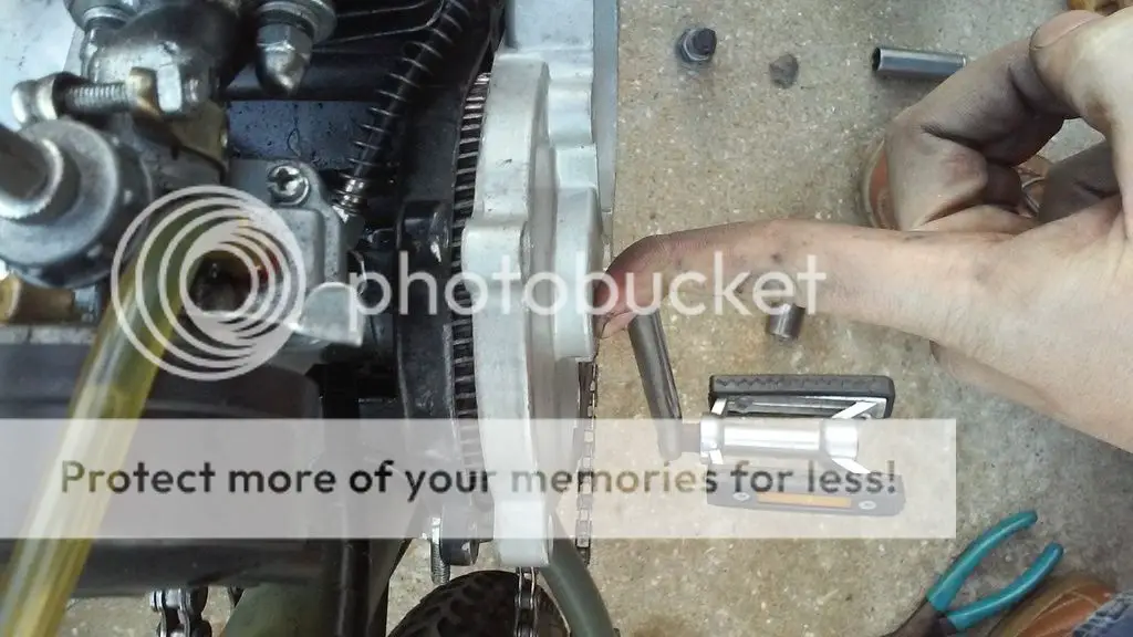

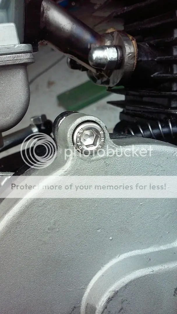

How far off it is with one other bolt installed:

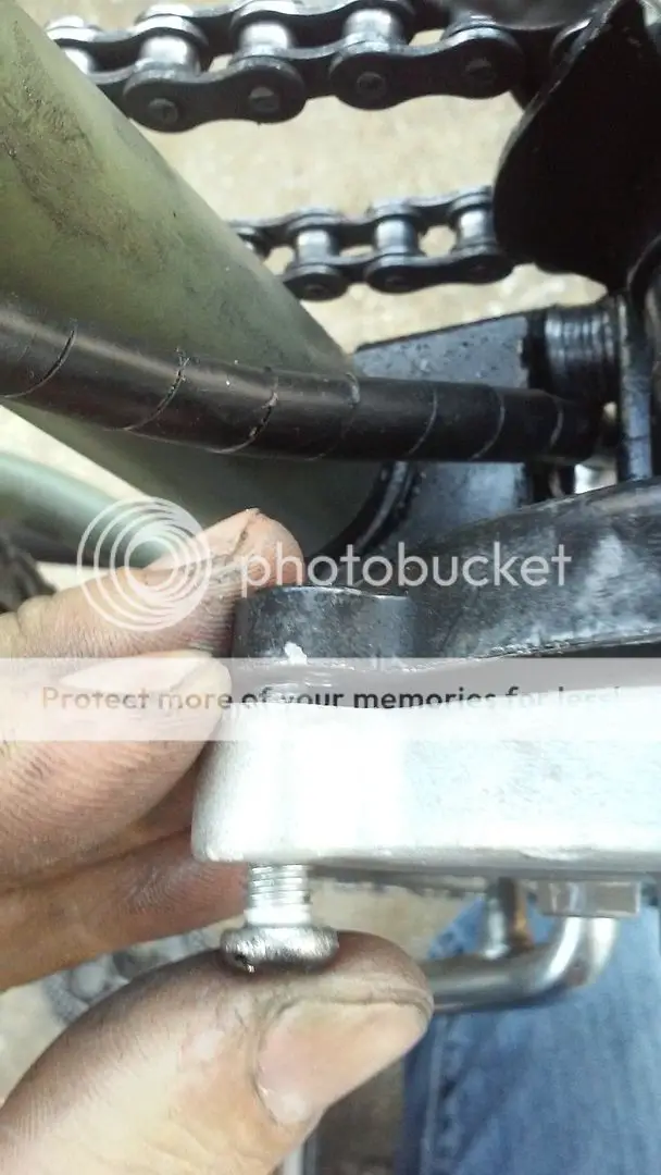

Here's how the cover sits with the manual clutch assembly installed (i did remove the whole clutch assembly for the first pic)

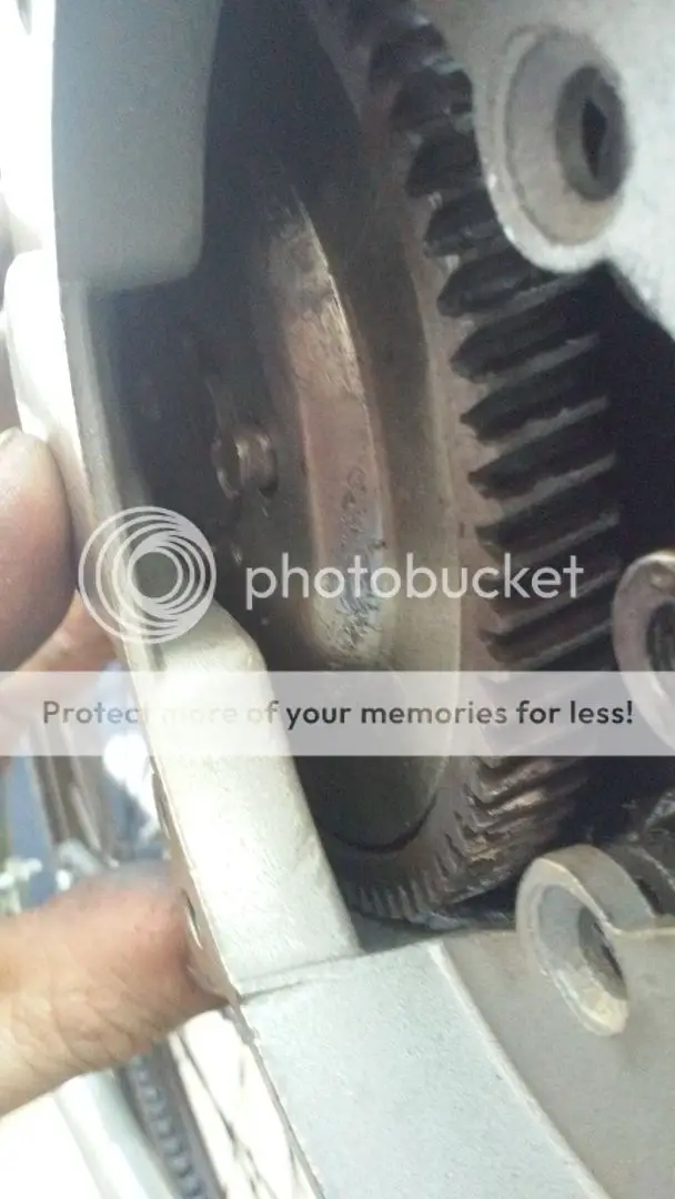

This is inside the cover, showing where the manual clutch hits.
Hmm...
I just went back and watched a YouTube video on installing the centrifugal clutch kit. His clutch gears don't extend that far out in to the cover. See the second pic above? Mine does.

The clutch cover is about 6mm (approx 1/4") too narrow. That's why some were saying to use like 5 or so gaskets. That's ridiculous. Use the old clutch cover. Cut the face off and lap it on some sandpaper like you would a cylinder head. Makes a much sturdier spacer.
