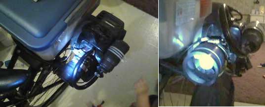

happycheapskate Nov 26, 2012 The first one I made dislodged, won't stay put, so I will try another one, with the wings cut down less, and installed just behind the air filter.
happycheapskate Mar 23, 2013 I didn't stick with the computer fan blade thing. I found rectangular Lawn Boy brand gray foam filters, and made 2 disc shaped filters out of each. 1 at a time goes in the rubber boot, with plenty of spares, runs great, quieter.
