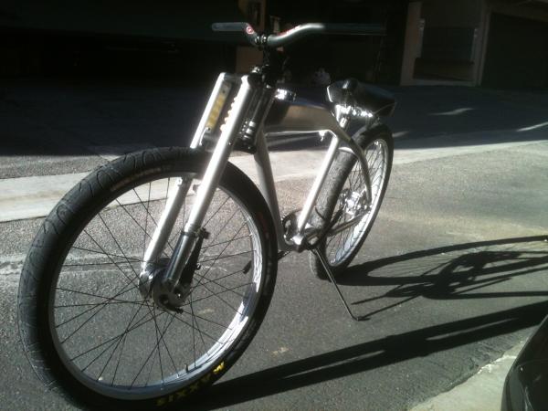

Here you can see the Sturmey Archer 90mm from drum brake with 3 watt dynamo. I used a 2" pipe clamp to attach the stationary arm for the brake(we'll s
the fatter tires might still fit. I did not have the front fork adjusted properly, so the front tire was hitting. now that the fork is adjusted properly (proflex forks are sensitive to stack height) I will try the fatter tires again.
